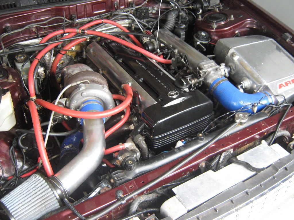

Started a front mount intercooler install on this thing last week. So far only got the cooler mounted, and made most of the pipes. All the silicon joiners are in the mail. Its just 280x300mm core with 2" mandrel piping made out of exhaust tube so i could weld it. Costs are roughly:
- $140 delivered for cooler
- $150 for silicon joiners
- $80 for 8 mandrel bends
$370 is more than i planned, but im sure it will be a valuable upgrade and worthwhile once the boost is upped in fuel is increased.
Put the boost controller on this arvo and put it up from 7psi to 10psi. I know this wont do much without fuel adjust, but i figure it will do no harm either.
Anyway, will take more detailed pics of how I ran the pipes once its done. Bit of mucking around, but no cutting of the car.

Such a sleeper haha water to air cooler aswell nicely done mate can not tell a thing if its got anything under there haha. What turbo you running? xr6 35R?
Mine wont be not so much of a sleeper anymore lol
Yeah mate, its off an xr6t. Just ground out the wastegate bigger and adapted the 10psi wastegate off the stock 2j setup. Goes quite well on the 10psi, so looking forward to finally winding it up. Its got a ported head and 264 cams as well to help it out a little.
What setup are you going with? A manual would make a Cressy a lot of fun.
Nioce dude! reposive galore there haha, dyno'd yet?
Mine is just stock 2J + R154 box, twin plate clutch running stock twins but did the rear turbo mod now acting a wastegate so running true twin. Hoping for something like 260-270rwkw on 17psi with a Apexi Neo and US 550cc injectors. Hopefully next couple months mine be finished just at the stage i need to wire it up and get dumps made up and little hoses here and there needs to be attached.
EDIT: did your 2J came out of another car? engine looks very familiar lol
Nah mate, not dyno'd, will get to it one day when it gets bigger injectors. At the moment it just has a SAFCII and i have a LM2 wideband logger, so no real need. Engine just came all moldy looking from an importers.
