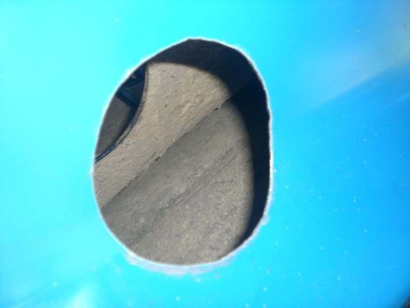

Here are some pics of a snorkle i made up on the weekend
started with making the hole, i drilled heaps of little hole then filed it to make it nice n round,Then i used pinchweld to finish off the hole
Umm just wondering, why didn't you just use a hole saw? Got to be easer than drilling lots of little holes and then filing it out?

Can i ask why you ran the snorkel all the way to the front then to only use flex to run it all the way back to the firewall?
