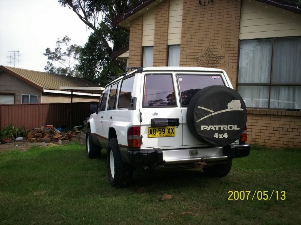

Back in 2007 I started with this.
A very tired and very stock 1990 Ford Maverick that had be rebadged again as a Patrol.
Well it was a Maverick and I am a Ford person so when I decided it was V8 time I had to put a Ford motor in it.
Motor and ECU was from a NCII Fairlane Ghia I bought and wrecked out.
