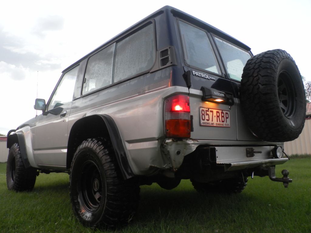

This is how the shorty stands after all the work has been done:

Discussion Starter · #6 ·
Ok now that your all up to date with the recent work here is a list of things that I want to try and get done:
Cosmetic issues (eg paint work, minor rust, panels, grille, just a general tidy up).
Rear end suspension (as you can see it doesn't flex much in the a$$ so that needs to be fixed).
Bar work (sliders and a rear bar, front bar needs to go in favour of a smaller set up).
Locker for the front and rear LSD shimmed.
Theyre the main things.
I just want to thank Jerry for doing all the work and turning it into what it is now. I would still be stuck trying to get up this hill right now if it wasn't for all the great work you have done.
