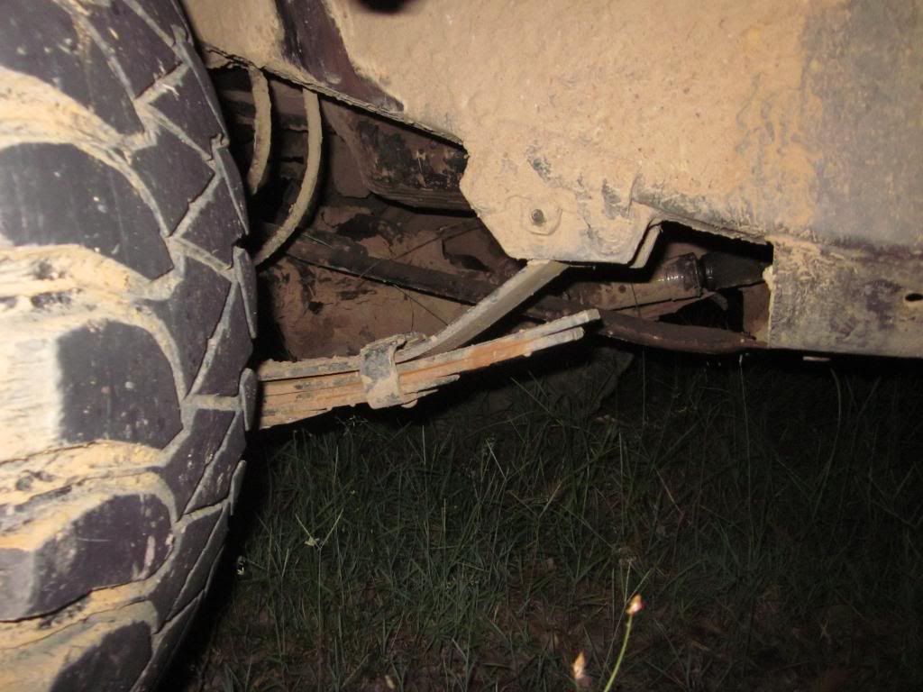

these next few are of the disaster that occurred during yesterdays run.. i snapped a spring which then pushed the WHOLE front axle backwards which pushed THE ENGINE AND TRANNY BACKWARDS. both mounts on the engine and both mounts on the gearbox are sheared off. so pretty much have a full floating driveline!!

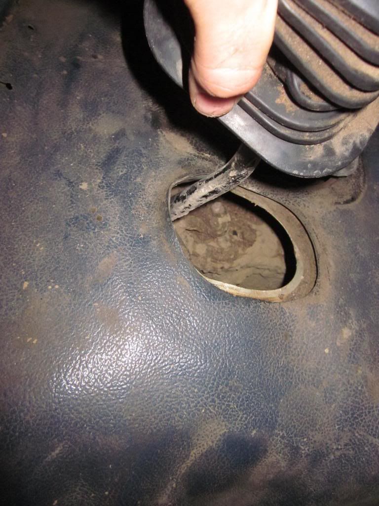

this is how far the driveline had moved backwards of the body!! that lever is in 2WD

far out mate, i havetaken my bus in some sily spots and have neve busted springs.
just smashed every window on the left, lost an axle, done a cv, smashed a door and a gaurd when some moron hit me, and the spring hanger tore off. and thats it not smashing springs lol

while ive got it apart im going to reverse the shackles to stop this spring bending problem i have.. so far i have bent 4 front leaf packs and snapped 2. thats like $700 in leaves in 6 months. HOW REDICULOUS:angryfir:

I have broken a front leaf in the same spot before - realized straight away what I had done so stopped and held axle in right position with a combination of a strap and the winch (to stop axle moving back and forwards) and reverted to 2wd, which meant I didn't cause damage to my drive train like you have

they are 2in lifted EFS springs. so i thought they were the best quality going around.
i called carrols today regarding a custom pack set to whatever design i choose and they will do it for $120 a side... so instead of putting flat hilux springs in the front (see one of screwy's threads) i can send in a drawing for say, a really soft 4in lifted spring and they will make it for me
