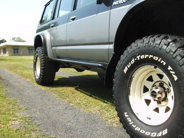

Hey mate loving the photos of the sliders progress, looking at doing the same myself soon. What thickness steel are you using.
5mm plate, only because I have a huge sheet of it. Probably would recommend using a bit thicker, but then again the weight really starts to add up.
Nice patrol mate, on my old 4runner i used a clamp on set up for my sliders and used 12mm flat bar and that still bent slightly when i came down on it, but brace the s**t out of it and should get away with it. good to see the outcome.

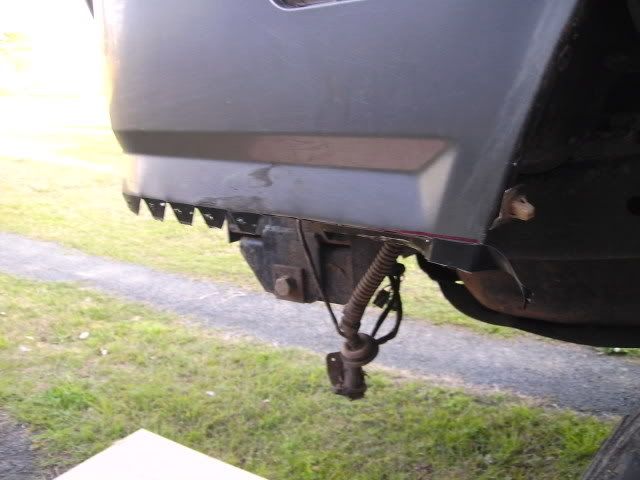

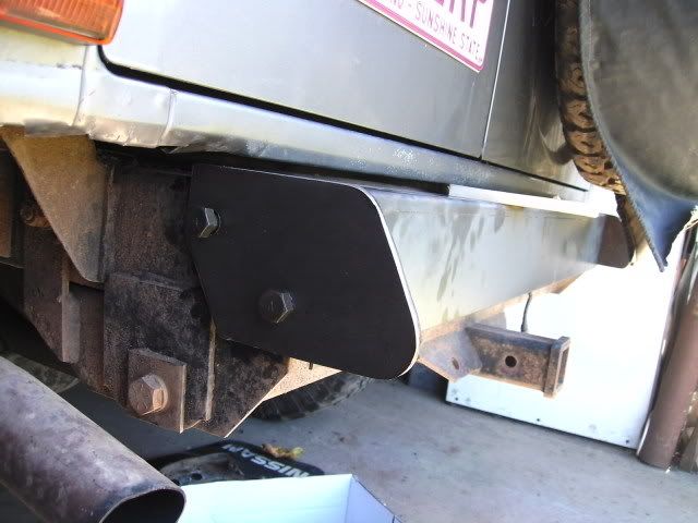

Update for my patrol!
After smashing a tail light, popping in a door, damaging the sills and mangling the rear quarters on a slippery night run, I got the motivation to build my slidders, cut the rear quarters and make a rear bar. So here goes...

Slidders in progress:
Nice!!

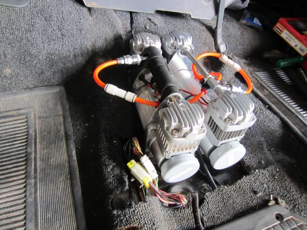

I decided to clean up all the wiring I had running everywhere and fit twin dual piston compressors under the passengers seat.
Twin compressors mounted with one way valves and pressure cut off switch. It was a really tight squeeze to get them under there as the floor steps down and they can only be mounted on the lowest part or they foul the seat. I also had to modify the lever wire to be able to move the seat back and forward.
Made up a bit of a wiring loom to go from the four switches in the center console to a neat place behind the passenger kick panel. I have a Narva 150 amp 10 way fuse block going to the two 50 amp relays for the compressors, a relay for the rear work light, 2 spare relays for switchable accessory and couple spare slots for the UHF and 12V acc/usb plug.
I also downgraded the front speakers from 6.5" to 5.25" splits as the bigger, deeper speakers didn't clear the window winders enough and made putting the windows up a pain. The smaller speakers suit it better anyway, less doofdoof looking.
