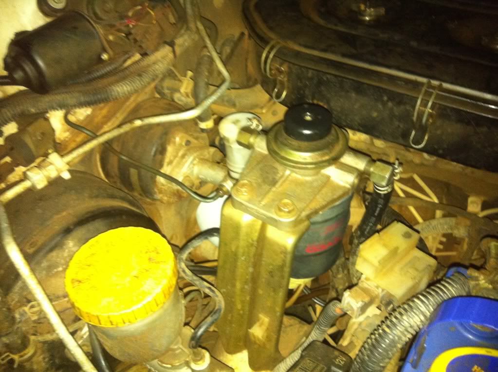

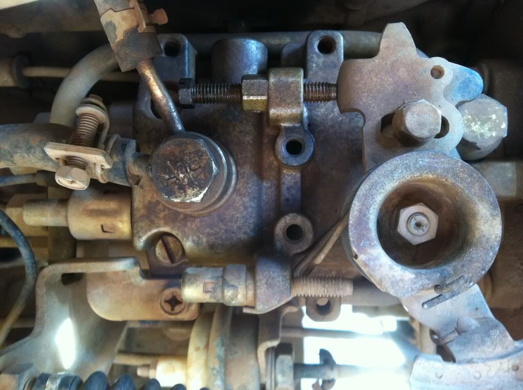

Dropped the fuel and changed the filter on the GQ and have gone to bleed it and run into a snag. The Gregory's manual says there should be a bleed nipple on the fuel return line banjo bolt of the injector pump step 1 and on top of the filter housing step 2, but as seen below mine has a blank bolt on the banjo nut on the injector pump and no bleed nipple on the filter housing.
As i do not have the bleed nipple, i was thinking of removal the outlet line on the filter housing and priming until i get fuel but then how does one bleed the injector pump without the bleed nipple. Do have have to crack the injectors to bleed the injector pump?

Seriously though OP, you just undo the bolt and pump the the plunger until you see no air come out, bleed nipples are for sissys.

On most things I've ever bleed you just pump em till they are hard and away you go. Apart from my inline pump have never had to crack a bleed nipple ever

As an aside, what model GQ do you have?
Your filter is mounted in a different spot to mine, and if possible I will move mine to the same spot as yours. Is that the factory spot or have you moved it yourself?

Do your outlet pipe on the filter first Few pumps have hose loose and pull it off,plenty of rags!, Do it at the filter a few times then go down and pump and crack the banjo bolt same thing do it a few times. Maybe go past a wrecker or IP shop and get the bleed bolt.

dont worry bout the bolt man, just loosen the one ya got!! hit that black plunger a few times till no more air bubbles and it should be firing.

Ya cant just loosen the bolt and pump you have to pump up the preasure on the filter pump to push the air through then loosen the bolt!

ive always just cracked the bolt, then pumped the plunger and watched the fuel stream coming out for when the bubbly ceases.

Ill'e try that next time! Just thought you needed the preasure there first.
The early GQ's had them on the passengers side (R/H drive model), the later ones are on the drivers side near the battery.
