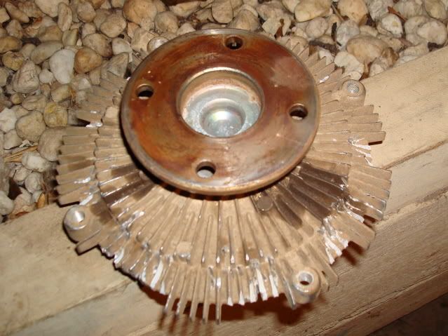

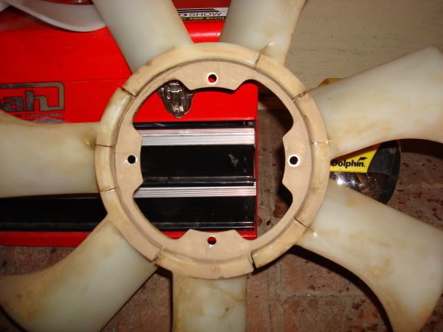

After finally getting sic of the constant noise my fan was making (the fan hub seized up about 6 months ago lol). I actually got off my backside and changed it.
Think the fan was a little overdue too :rolleyes:
New fan and hub to go back on.
The old hub after I finally got it off (think I smashed my knuckles about 80 times)

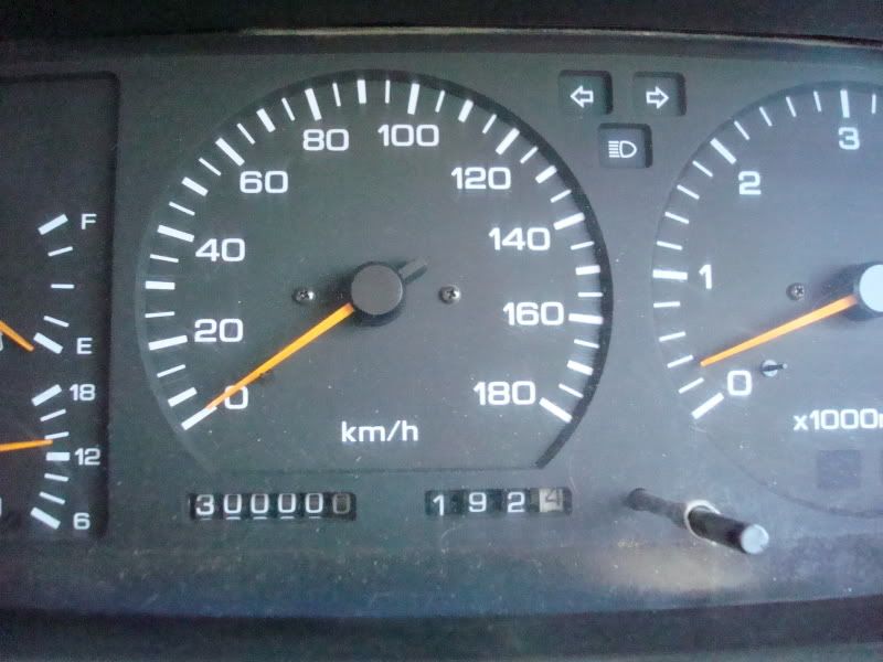

The old girl made it to 300,000 on friday.

At 300,000 kms perhaps a bottle of Slick 50 or Nulon & the fan's been replaced will you be keepin her?

Yeah Sam, dont think I could part with it yet. (plus I dont like the idea of smashing up another car lol).
Think a heart transplant is on the card's, but will wait till it die's (maybe 400,000 ;) )

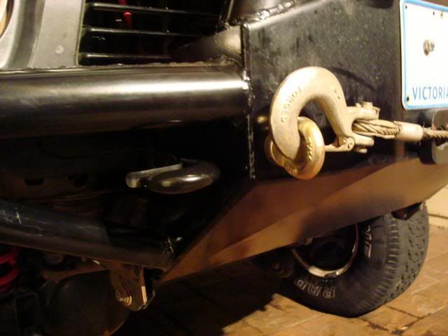

Small update,
Finally got off my backside and got my front recovery points sorted out.
Just had to find someone with a big enough drill lol, thanks Marcus.
Now have an eyelet for the winch to hook onto and a rated hook on each side for Snatch recoveries.

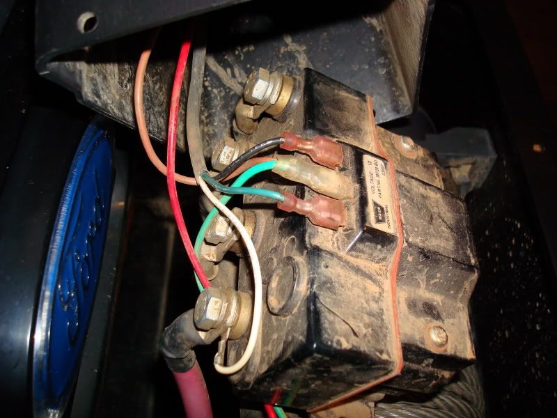

Bit of an update.
Had my first minor issue with the winch..
The controller would wind out but not in. Borrowed a mates controller and it worked both ways, so got us out of trouble (as I was winching him from behind after he burned his winchmotor out lol)
So I decided to wire up an incab switch because a new controller was going to cost me $180.
But as it turns out, it was a problem with the earth inside the controller. So now that the incab is all wired up with a new earth, the controller works both ways again lol.
The 3 plugs across the front of my solinoids are what I tapped into (In, Out and earth in the middle.
I wired up a on/off switch to only have power with the ignition is on.
Also has a light to show its on.
Had to use a duel pole rocker switch with earth running back to the winch and to the dash.

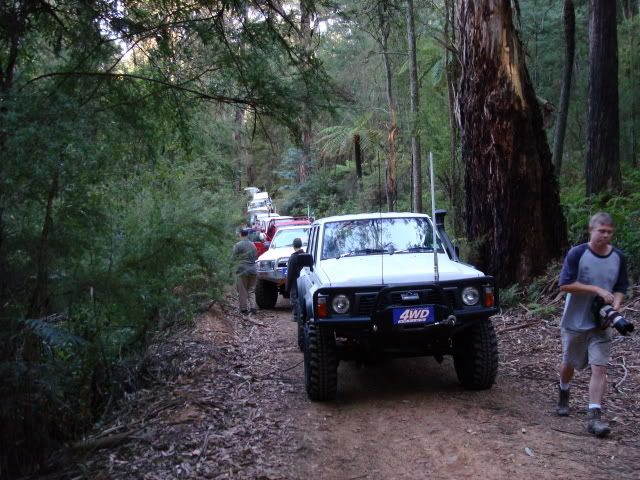

Couple of pics from the weekend.
Headed out on a trip with my usual Group and 4wd action magazine sent a photographer along to get some pics. Hope to see them in the mag one day.
Was a bit of carnage on the old mav, 4 new dents a busted tail light/bent bar and I burst a brake line 3 quarters the way up a nasty climb. That was fun :rolleyes:.
Hopefully Ill get a copy of the photographers pics at some stage, but these are from my camera.
