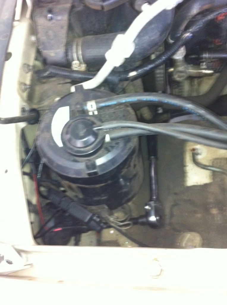

i'm moving stuff in the engine bay to fit a TD24T airbox and an ARB duel battery tray.
its a TB43e motor
now i know roughly wat i have to do, but also i wanna clean it up

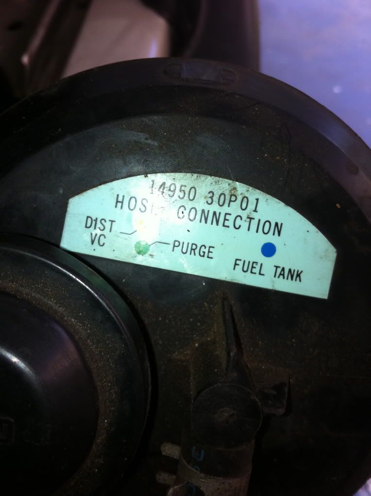

i've stumbled upon this
what is it? do i need it?
and how do i get rid of it??
any help would be great, caue i cant do much until i know wether to keep it or bin it...
Banned
117 Posts
You need it. It is the charcoal canister for emissions.
You can mount it to the chassis rail between the power steer & radiator hose...
ETA: RE: relocation, Maybe not as I just looked at the pic. With my 5 litre you can as the engine is not as long as the 4.2
Banned
117 Posts
You could probably relocate it to the otherside between washer bottle & drivers headlight.
You would have to drill a hole through the floor to vent fuel when over filled etc or run a hose off the bottom to atmosphere. Use some longer vacuume & fuel hose and it should be fine...
199 Posts
go to the wreckers and wonder around and see what other shapes/ sizes you can find you might find a smaller one to fit in easy
