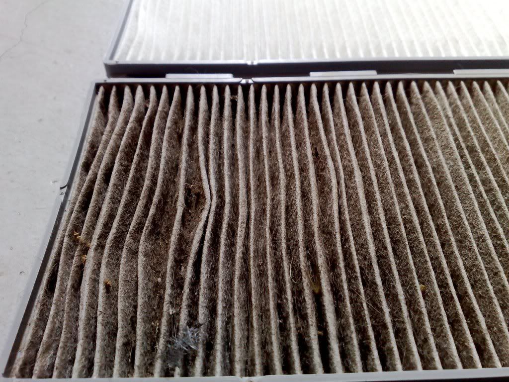

fitted the incabin pollin filter... filters a bit more out than just pollin!

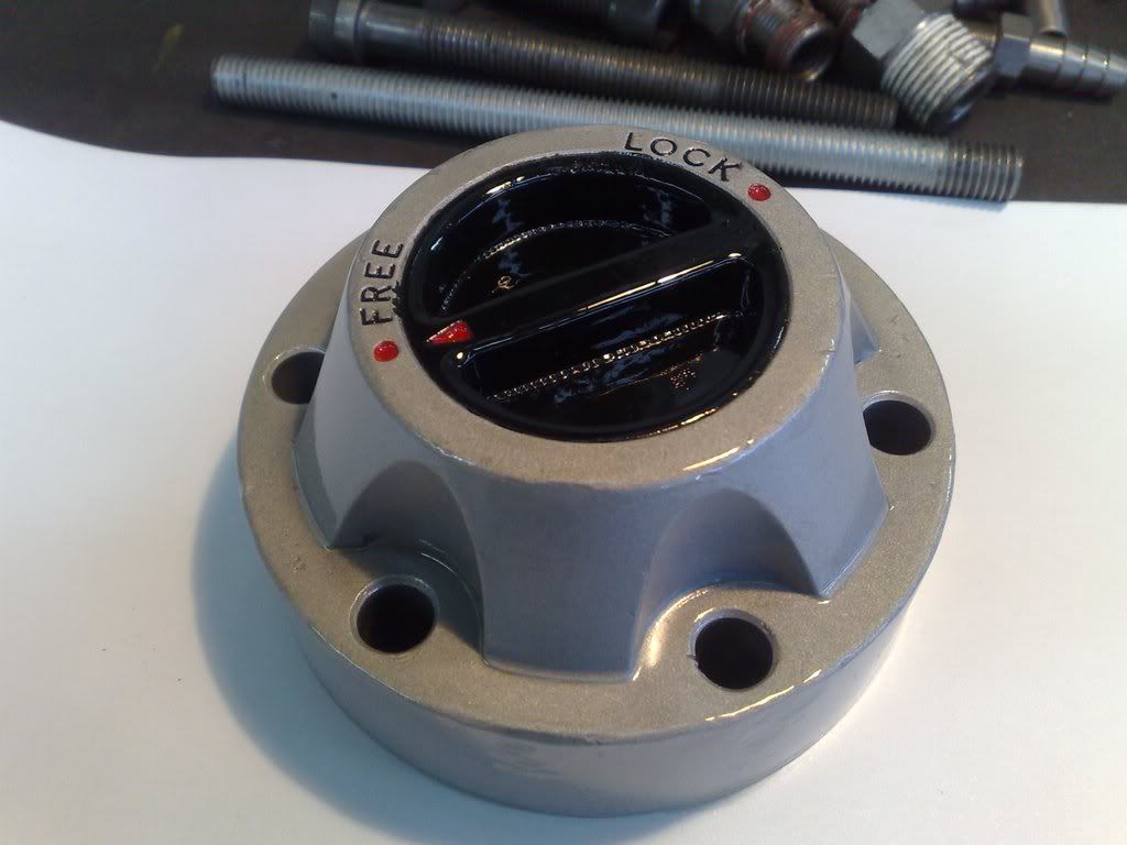

auto hubs pooped themselves so i reco'ed some GQ ones.

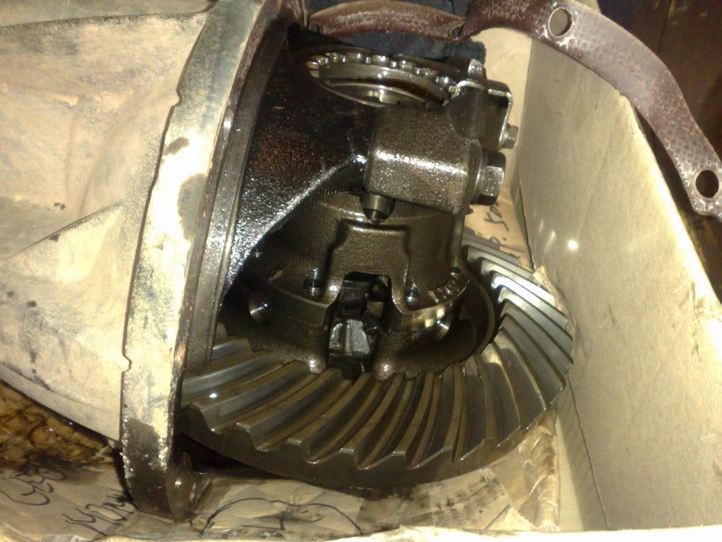

managed to blow a rear diff with spirited driving.
note the GQ centres are some what larger in the hemisphere!

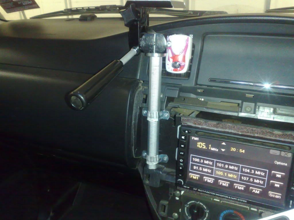

made a camera mount..tried making one to fit onto the driver grab handle but had vibration problems.. this works well.

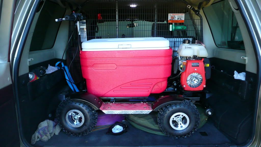

bought this but transporting it was an issue.
so i butchered the swing arm for jerry can holder since i fitted a LR main tank
why carry logs back the fire :victory:
Reactions: 2
Hahahahahah that's friggen gold mate hahah
Top work
That is by far the COOLEST mod i have ever seen!!!!!
:D its running a battery too .. so i got a Rigid industries LED driving light and LED tail lights.. got that LED strip lighting from Jet6 and lined the inner with it too.. nothing worse than not being able to find yr drink in the dark.:cool::cool:
