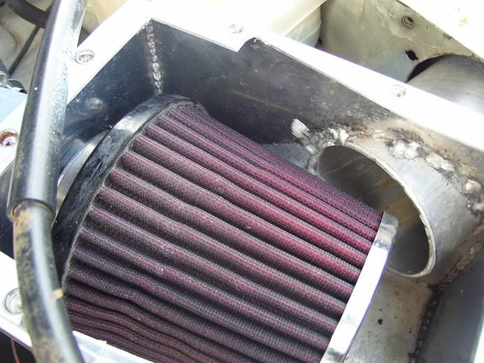

Sorry no build pics but if you want to use a full length snorkel heres how one can fit. Only thing needed is to move the overflow bottle back around 40-60mm and slightly move the aircon pipe be carefully not to break it though, as you can see mines alittle new
Made from 1.6mm ali and miged up

you rough bugger!! why didnt you tig it up?
looks the goods though mate, should have ya donk breathing heaps better now!

was going to but thought its only there for a purpose and it was a rush job as i needed it for the levuka weekend

whats wrong with miggin it the welding on the outside around the outlet pipe looks pretty fair. ive never done any tig whats the benifits over mig on alloys?

That's pretty awesome. There is a market for these as most have blown up (especially the ones on dual fuel).
Mine has split. Spoke to Mr Nissan and was quoted approx $700 for a genuine one. Ha! Bugger that.

Thanks for the comments guys. I couldve used the tig but as mentioned i needed ot done quick and seeing as its no show car the mig was quicker. As for the filter in the pics its a $25 cheapie from autobarn i now have a KnN sorry dont have part numbers.

Tower if you don't mind mate what are the dimesions of the box

I will have to get them for you tomorrow mate will post them up in here.

Ando the dimensions are 230mm long 180mm wide 180mm deep. Cheers

that filter is a but on the small side for a turbo diesel, just about right for the petrol though.
Nice work.
Why is it too small?

It seems to be working fine for me at the moment though, the filter isnt a problem if anything the box is slightly too small. The box has a drain point so it cant fill with water.
