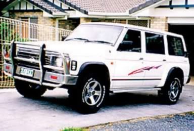

My wagon has gone through many many changes, heres some info.
original

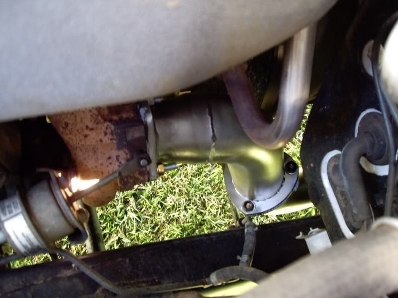

Then it had a cheap 2" kit

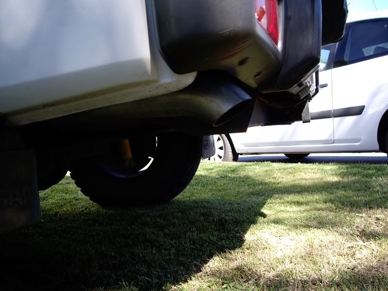

Then 3" dump pipe and exhaust

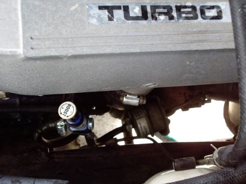

Boost controller and guage

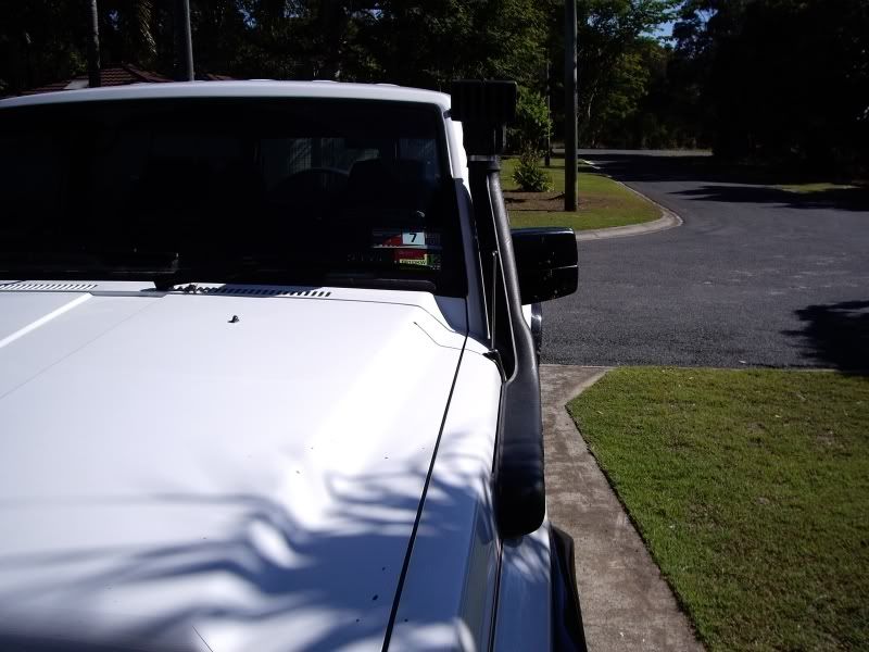

Snorkel

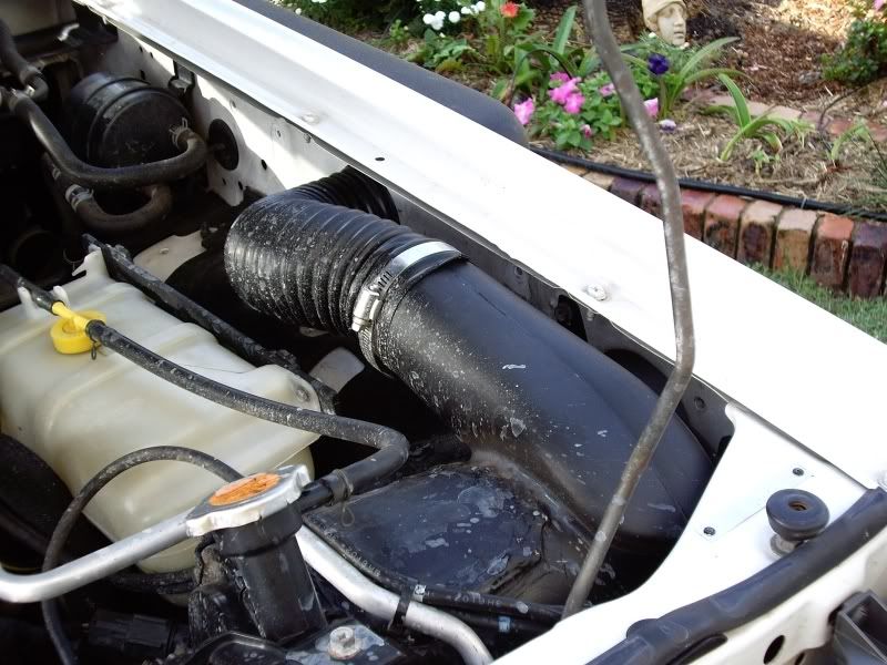

Then upgraded the standard airbox to a donaldson

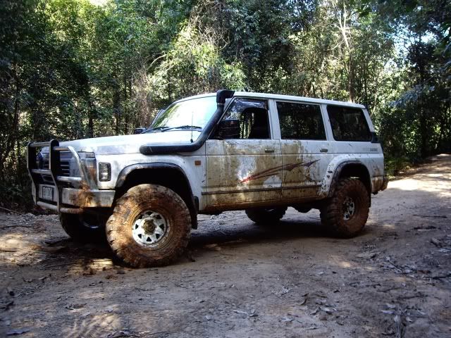

New coopers 255/85-16 bit taller and bit skinnier than the 33s and much better on road and in sand.

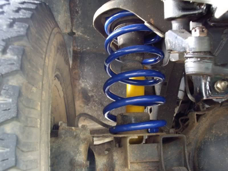

Now it has 3" springs.
