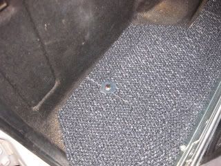

firstly i made a masonite template so i could locate the tie down holes and also to have it in the shed if someone wanted to borrow it.

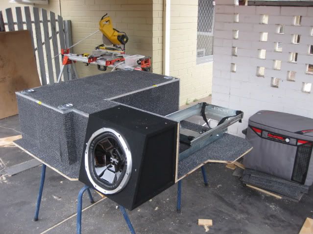

i then cut the base out and positioned the engel slide

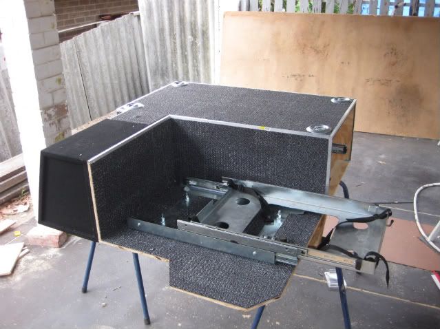

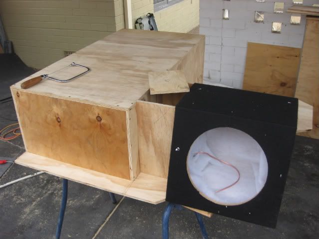

i then made the frame work for the drawer
then added in the sub box which i purchased for 50 bucks

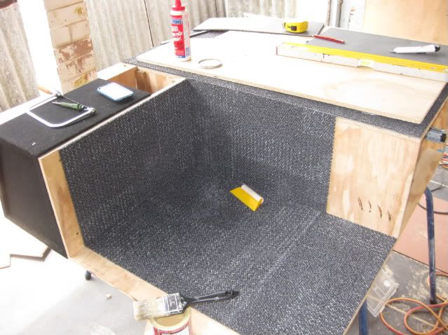

then i covered it with carpet tiles i had lying around

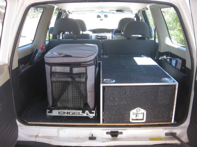

then i made the drawer to fit (cannot upload this photo) and fitted it into the truck
i fixed it to the floor using four existing points some 50mm m6 high tensile bolts and some mudguard washers
all up cost of about $300
