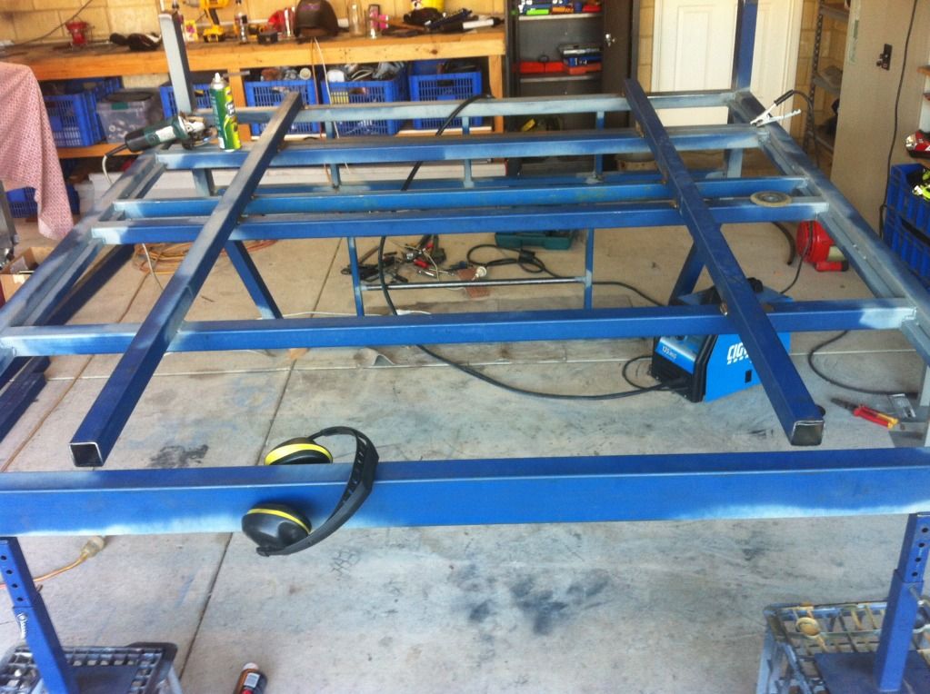

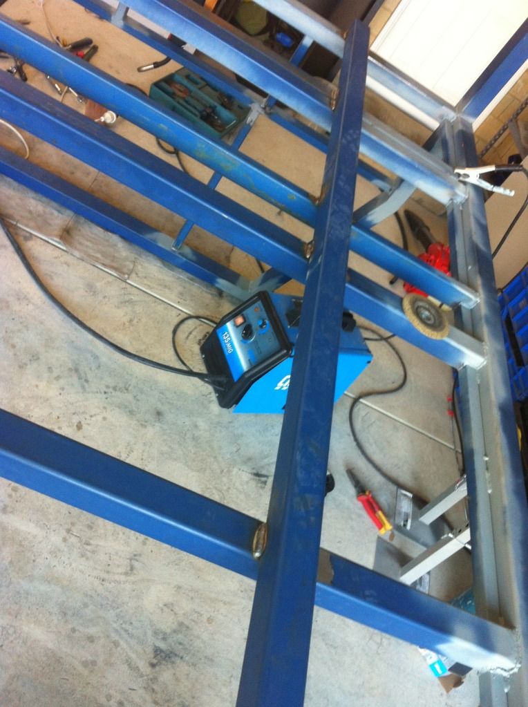

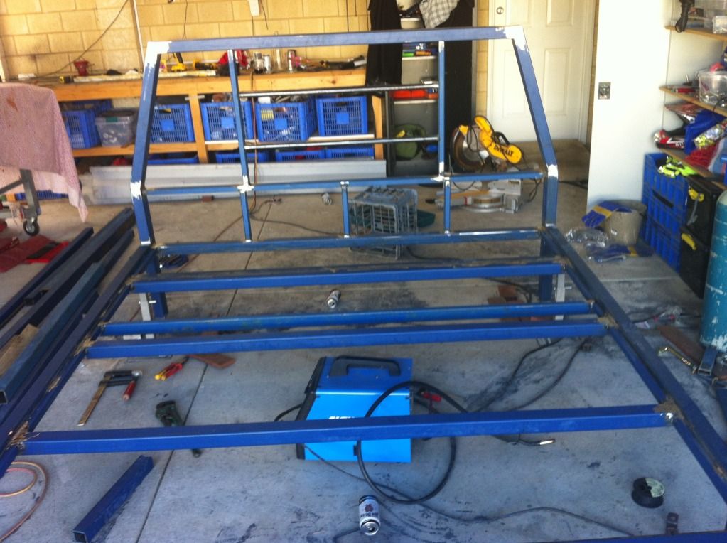

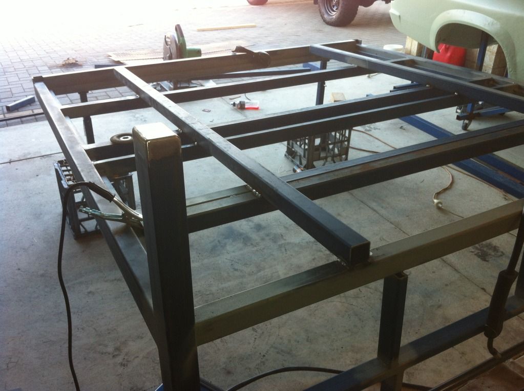

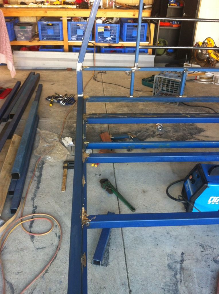

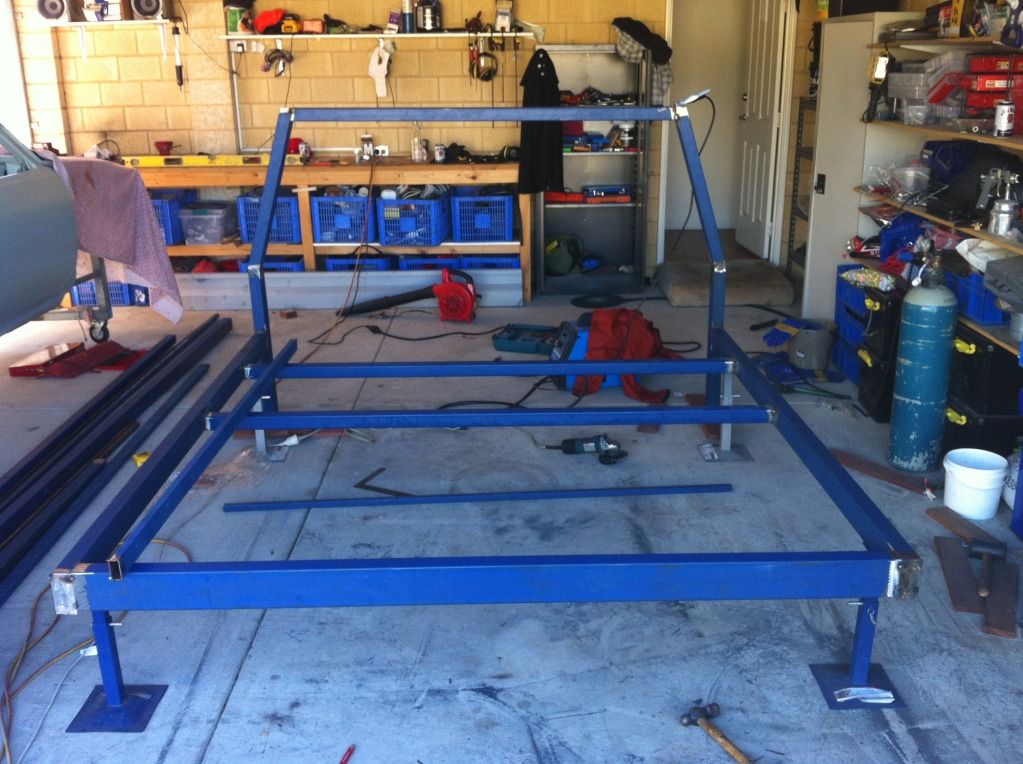

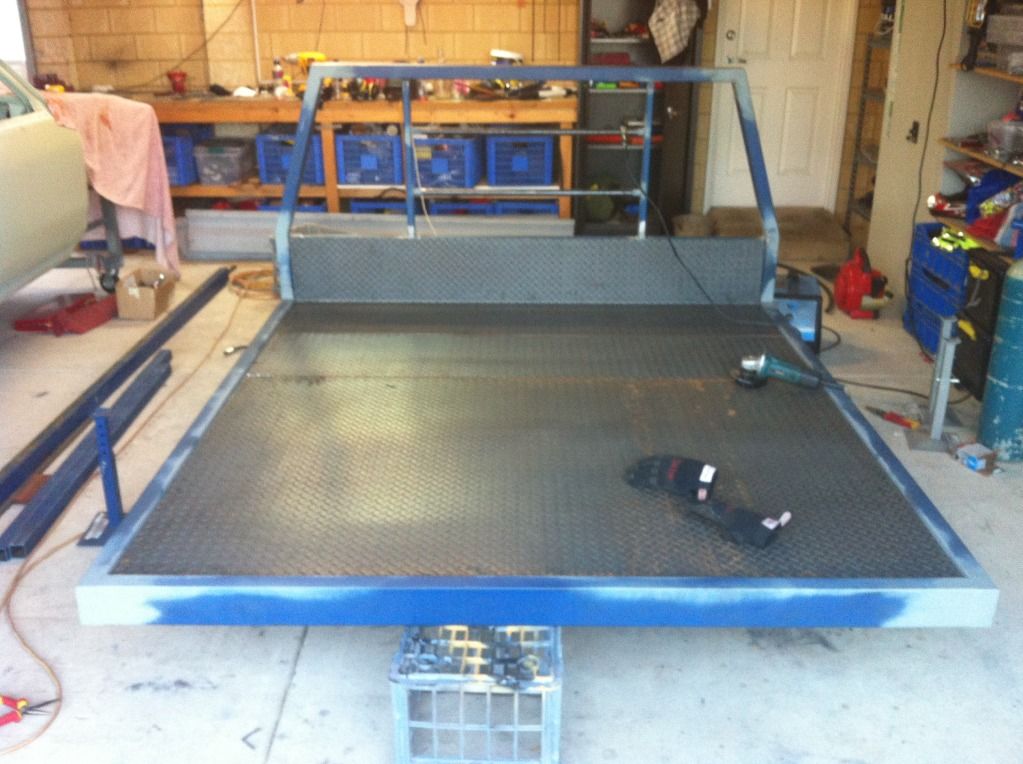

we all know what they look like standard so I will start with the tray build...I decided to rip the prone to damage ally tray off and get to work with something a bit more heavy duty, so i did some research, employed me mate Paul (as the offsider) and went and brought some steel.
Heres the progress pics
#3 ·
thats where i was up to at the time i have not loaded any more pics of trays progress onto the bucket yet.. but back bar and hard ally checker roof to come yet..will update the trays progress soon but i'll show you the slider build, so here it is.
