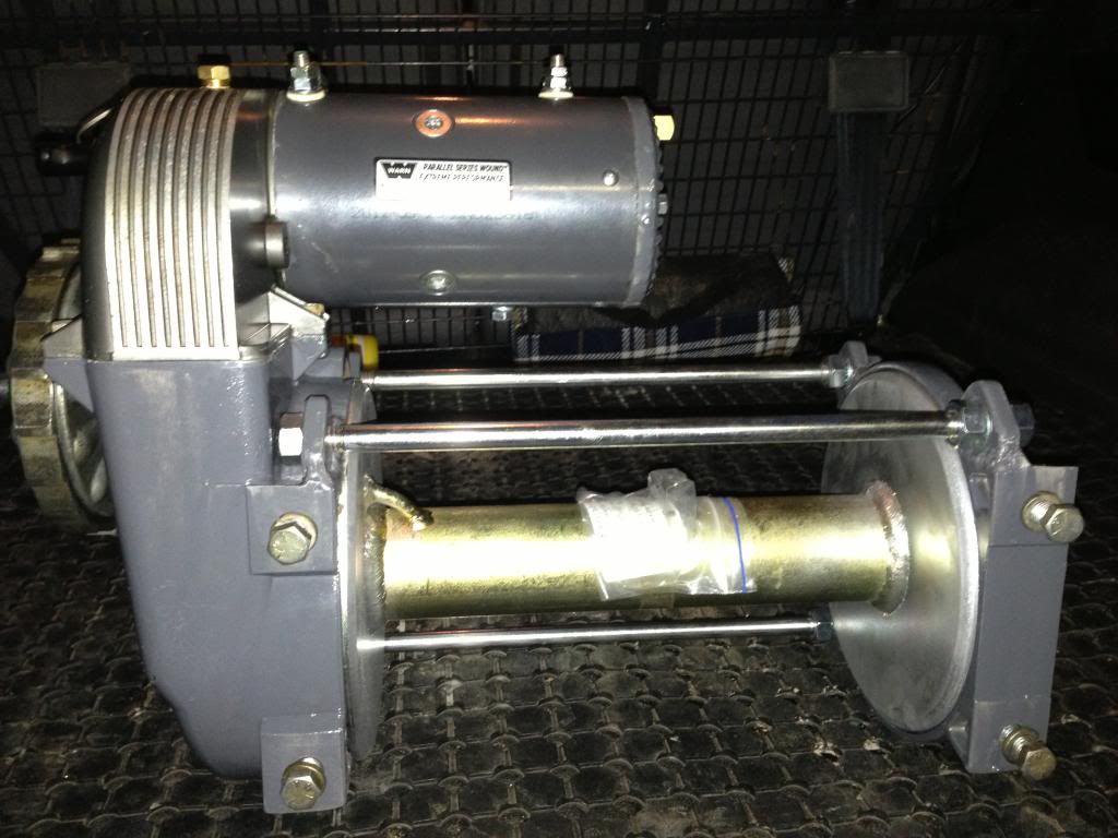

My M8274-50 was bought new in 2000 making it only 13 years old , its having a mild make over with S G Leslie & Sons Pty Ltd.
New 6hp motor to be stripped and rebuilt, oil fill and drain plugs, breathers, clutch pinned, brake shoe upgrade, I also have a new Gigglepin main shaft to go in, Delta-tec 76mm longer free spool drum, 3 braces to keep it all lined up and the rest of Mal's wealth of knowledge to build which should be the Icing on the cake for what I believe is the best winch ever built.
A big call maybe but the proof is in the pudding talking with Mal and looking around his work shop he was showing me a 1972 model that had been through a bush fire and was rebuild ready to go again.
When I bought my drum from Roadrunner Cam mentioned his was 35 years old and had been used as a comp winch after being rebuilt from scratch. In this day and age were the majority of products aren't built to last its nice to know some are still kicking and only getting better.

Thanks Leethal, the last thread Brando put up was the one I was reading that started the ball rolling for me. One of those things on the to do list but after researching here and other sites bit the bullet and set my winch up to suit what I wanted.
Was considering rebuilding it my self and I did tear in down for a look but I've heard many a good thing about Mal Leslie and just wanted his experience and knowledge gained from building XXX amount of winches for competition use. Glad I did because has improved on a lot more then what I could have, what he has done is built my winch up to something that with a bit of care/maintenance should last me my life time.

Picked up my high mount today from Mal Leslie, few dramas setting it up but all sorted now. All the usual modifications very happy with the quality of work performed, and attention to detail. The little things make a difference like chamfering the edges on the drum to eliminate any potential for the rope to catch and get drawn in to the sides of the drum. Bushings in the gears to keep it all alined and stripping the motor and painting the internals to prevent rust etc.
The plan is if the Victorian comp scene gets back on its feet to have a crack at Vic Winch, set up a Gigglepin twin motor gearbox top housing and faster gears. For now I'm happy with my set up and should get years of service out of it to come.
