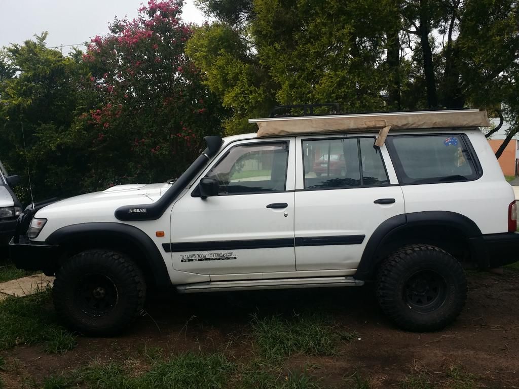

Hey guys long time lurker on the forum but have mostly flown under the radar
Picked this up off deccers on Thursday very happy with my purchase :)
99 wagon factory 4.2 that's had a stock gu turbo put on not going to be fiddling with the motor like I normally would other than an intercooler
Has a 2 inch lift
33s which I'll be needing to replace 2 at some stage soon
Roof rack
Awning
Light bar and Spotties

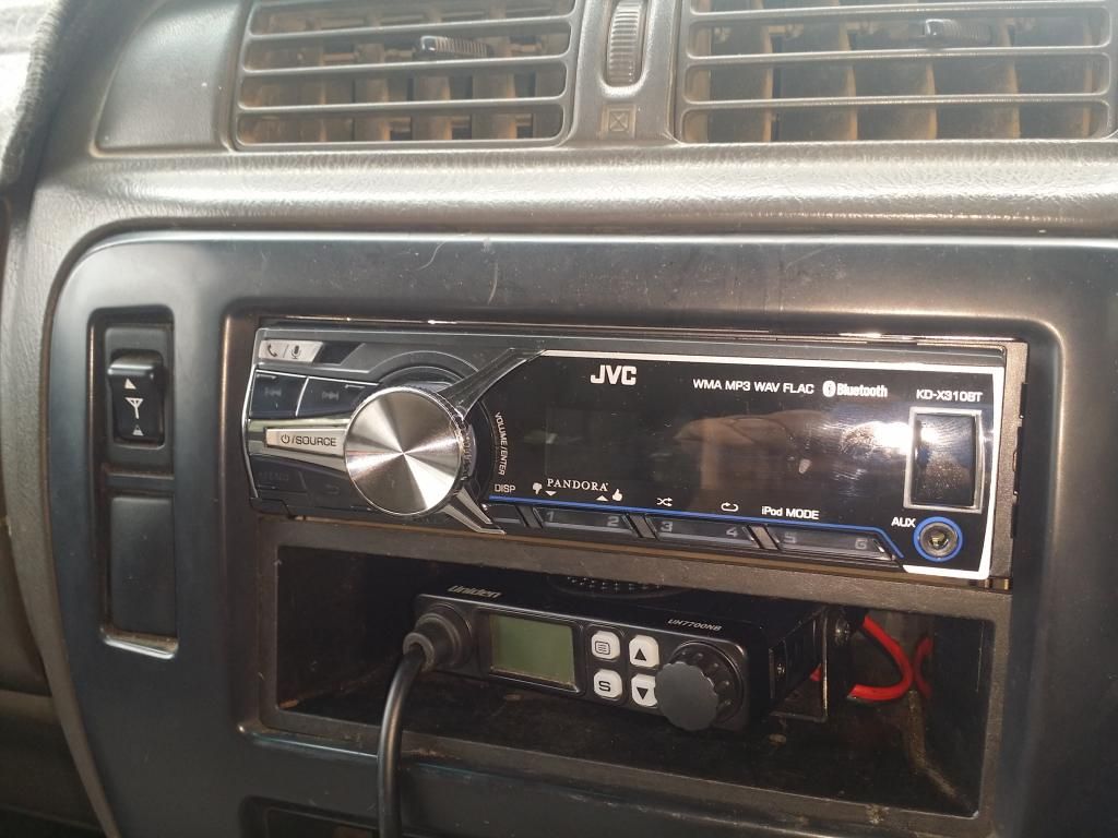

Yesterday I installed a jvc Bluetooth head unit and installed the microphone on the a pillar at the top of the trim
Best $149 I've spent haha while I had the dash apart I took the chance to rewire it all and tidy it up

New stereo

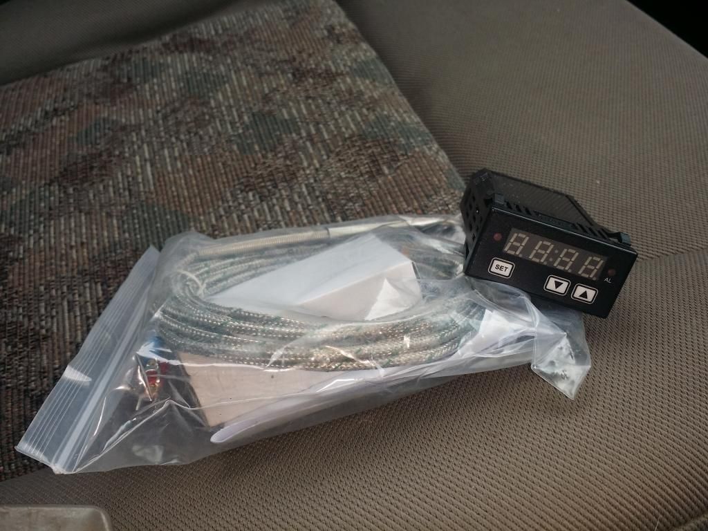

Boost and egt I bought

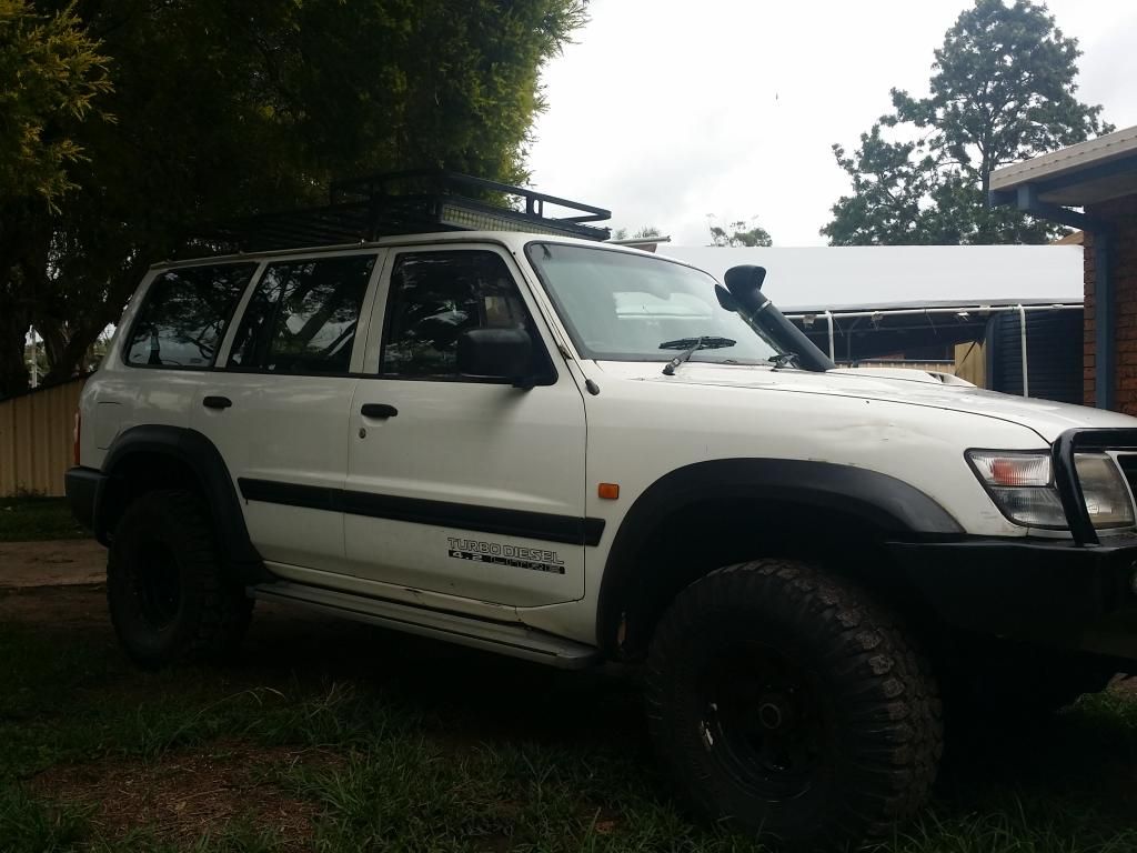

And testing it out the day after I bought it this was on the way home from Work

Egt probe fitted pre turbo at the collector reason for going pre turbo is I prefer the accuracy and not having to worry about temp loss across the turbine. Stick to 650 pre turbo and I'll have a very safe tune �� there is a small oil leak around the turbo and at the intake where I have a small boost leak... Is it common for ht18 turbo seals to go?
