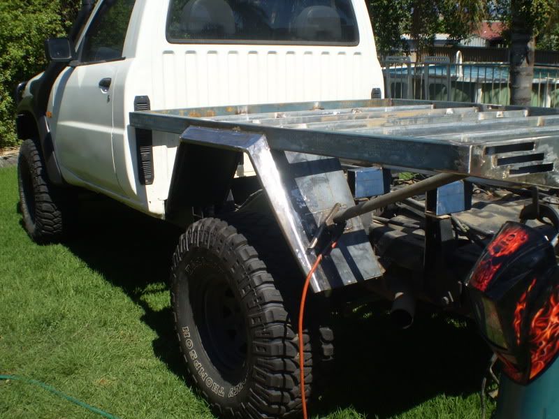

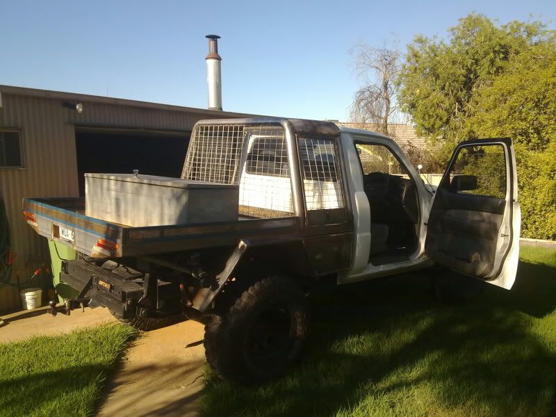

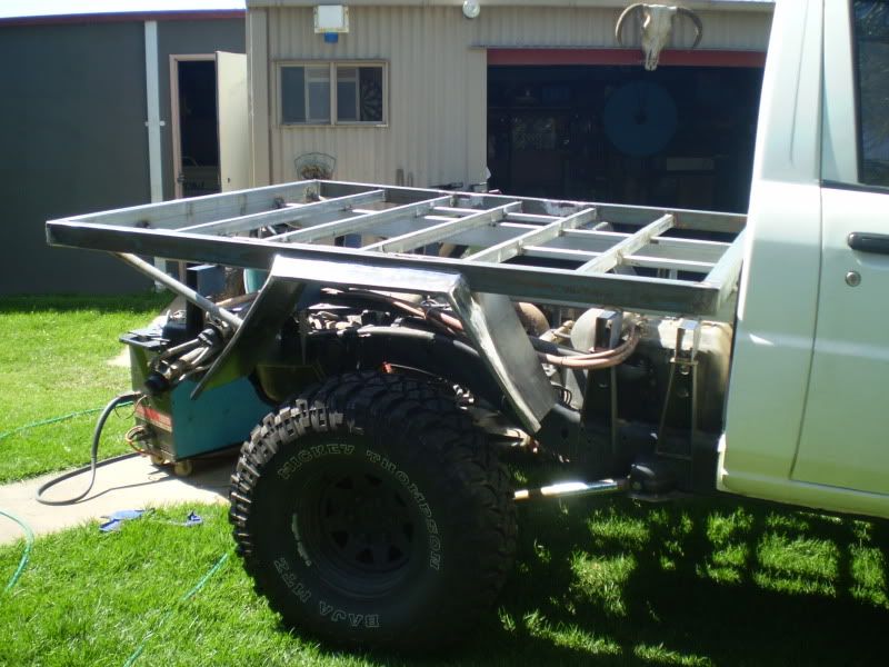

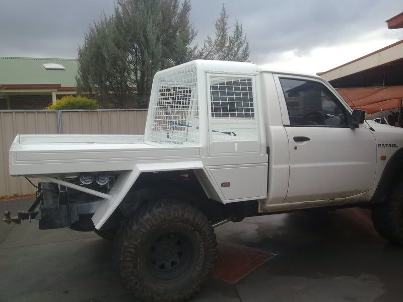

hey, new to the forum. just thought i would throw a few pics up of my ute. had it for just over a yr now and since then have built tray, pwr intercooler, suspension, tyres.
just bought a diesel gas aus system for her and am planning on making a start on install very soon hopefully. ute runs 16-17 psi and gets along real nice.

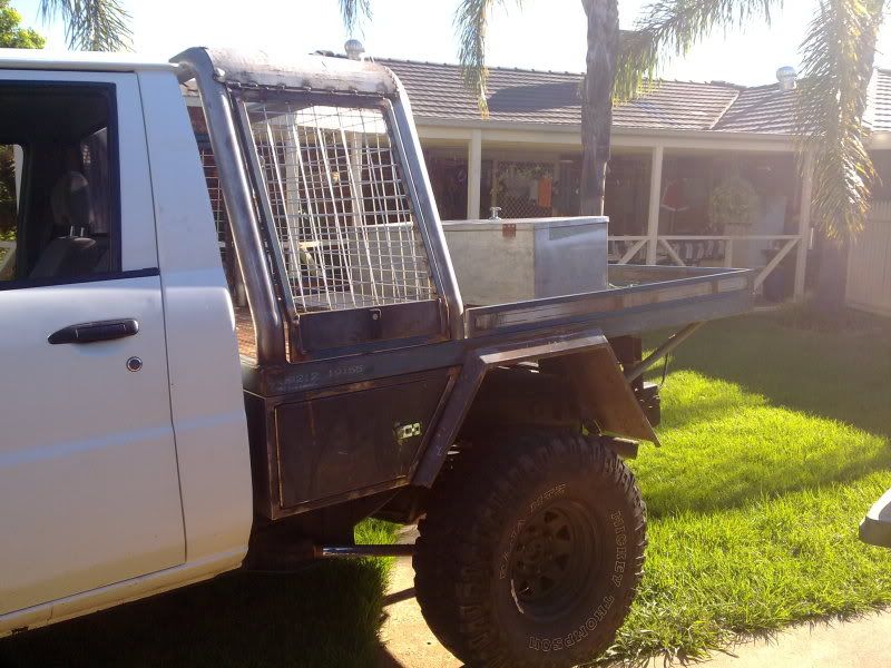

what is the overall lenth of the tray mate and how did you make the roll bars for the cage, did you get a metal shop to make em or did ya do it yourself. awesome tray mate!
416 Posts
Discussion Starter · #11 ·
sorry for late reply, tray is 2100mm long, and i had the bars made up at a local shop, they r able to mandrel bend up to 5"

Love what you have done with the tray and I hope you dont mind if I use some of your ideas?
Are the sides removable? I dont want full size drop sides and looking at sides like you have done.

yes sides are removable, i bolt them in, originally i drilled a hole straight down through the 75mm and out the other side and used a T bar allan key to push the bolt up through the RHS then through the side and then tightened it up, never had any problems with them rubbing or making any noise, can be a bit of a pain if u want to take them off all the time but for me i leave them on. over summer though im going to drill a bigger hole in the top of the RHS and weld a nut flush with the top of it so in future all i need to do is undo a bolt going down through the sides.
As for the flares i folded up a length of 2mm and just cut angles and folded and tack it til i was happy, a bit of stuffing around but im happy with how they came out.
ive emailed photos of the tray build to u mate, hope they help
