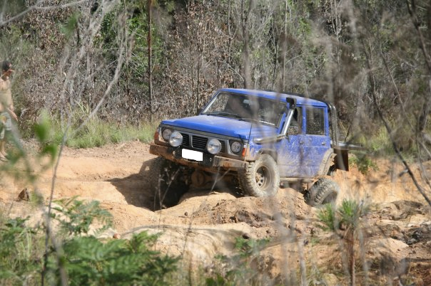

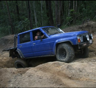

Thought we had better see how it goes stock in the ditch around the corner. it didn't go so well and nearly go it stuck hah.

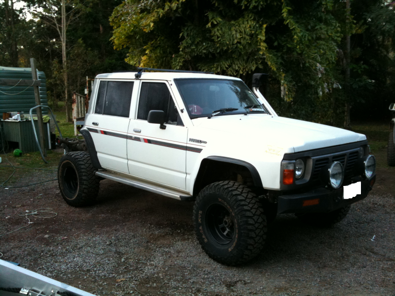

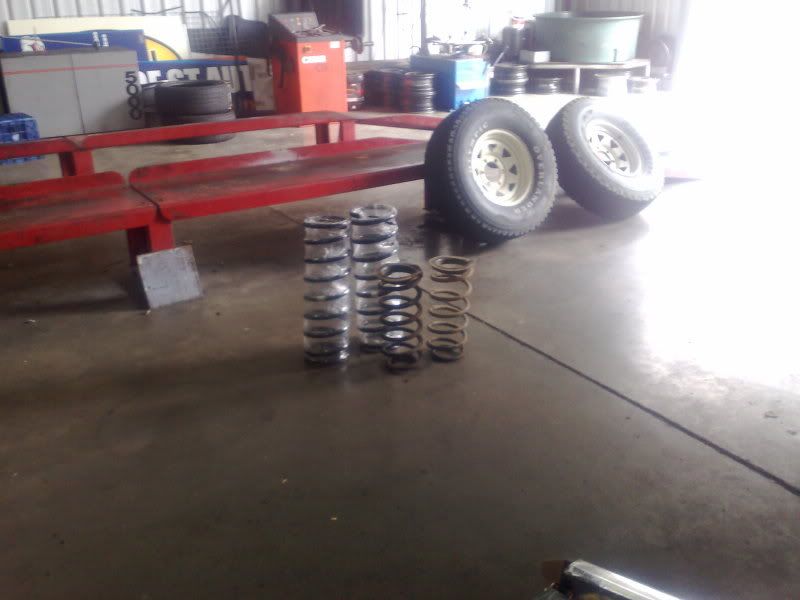

couldn't leave the stock suspension in it for too long so it was ditched in favour of a 5" superior engineering kit with HD springs, EFS extreme shocks, superior panhards, castor plates & brake lines. A mate and i cut the rear quarters at the same time.
At the same time i added a set of 35" Hankook RT03 MT's and a set of 15" rock crawler big offset steelies and went for a second test in the ditch
it didn't change much for quite a while but had alot of fun in it.
i got given a 3.5" Safari snorkel head as a gift cos i wanted to make a stainless snorkel so i tracked down all the pipe and bends, cut everything to size and took it to a mates dad who is plays with stainless for a living and he came up with this!
i ended up getting a very lucky defect notice; lucky in that he could have got me for a lot more or made me go over pits.. but he was a cop on a bike specifically looking for oversize tyres (HE HAD NO IDEA!!!). By this time i had also put a Denco turbo kit on it with exhaust stopping right before the rear diff. With the defect notice i decided to track down some 33's and i swapped my Hankooks for some MTZ's (which i wouldn't recommend nor waste money/time on ever again)

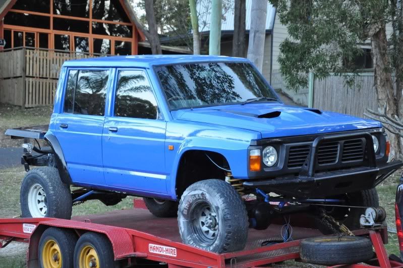

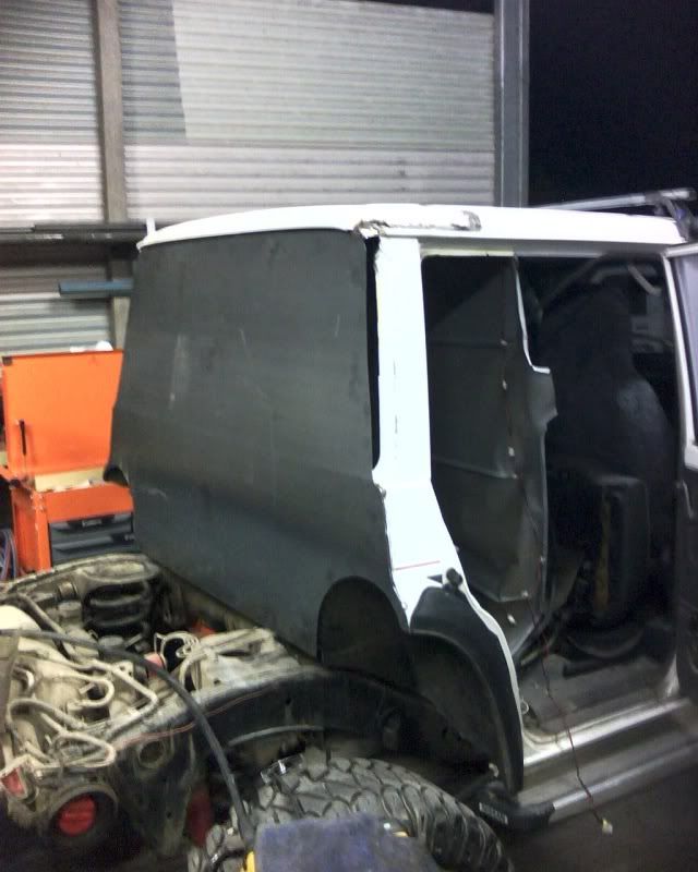

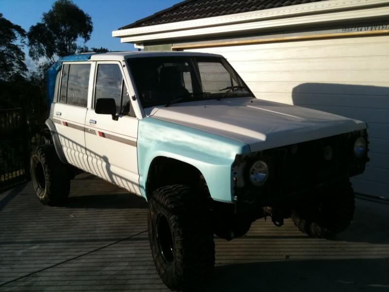

it was my goal from the start to end up with a blue dual cab and it took a long time to get there but the cut down began (performed by Bowie at Beerwah)
and a strip down and prime for paint
also got some sliders and my tray (also built by Bowie) and i modified my bullbar and got them all powder coated by caloundra powdercoating
with the ute back from the Painters the piece back together began.
with the ute put together it was time to improve the suspension setup some more. did this by sticking with Superior and went some mecavel Draglink and Tierods. Also sick of the limits of castor plates went with some superflex arms. Results were fantastic!

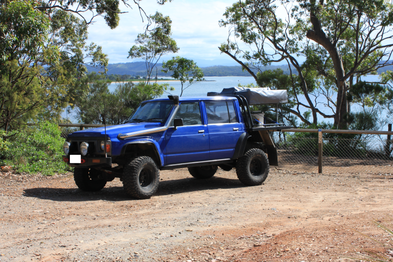

We bought a roof top tent and i made up some frames for a 5000km trip taking in 5 states/teritories from Brisbane QLD inland down to Tamwoth NSW, on to Canberra ACT, then to Melbourne VIC ending at Mt Gambier SA. We turned around and drove back along the coast from about Eden up and all done in two weeks. A lot of driving but the girlfriend and i loved it and the "Ebay Special" Roof tent performed flawlessly!
Since then we went to Expo weekend at Cruiser and had a great time, even gave her a drive on camp road. she got some photos of me heading down.

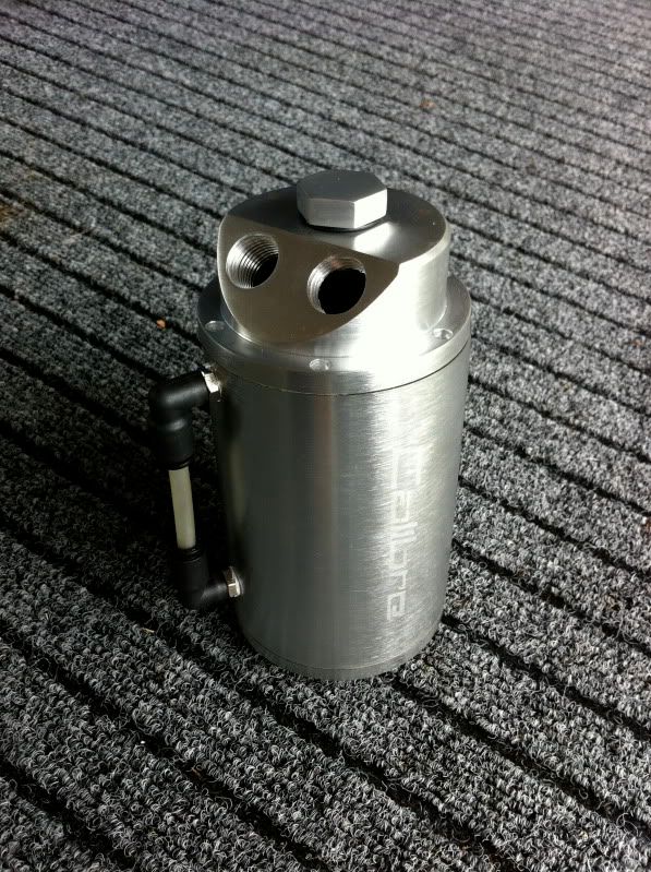

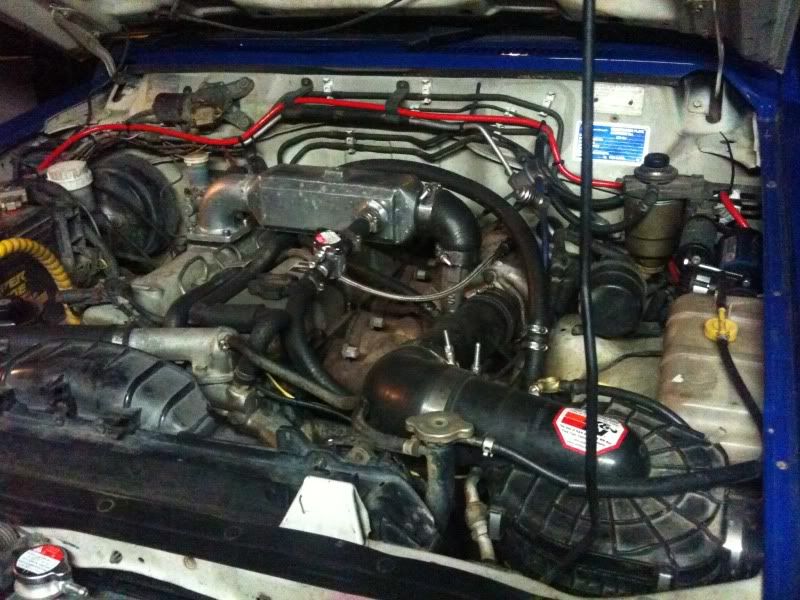

bit of an update got some free time so i finally finished the install on my second battery (a ***** of a job) as well as an oil catch can (long overdue).
Catchcan
started with one of these
with the idea of modifying one of these to fit inside it.
in the end i got the *****s and extended the outlet tube a bit lower in the can and stuffed it full of steel wool. its no provent but it should be better that nothing.
and the battery tray is made out of some ally aircon duct, builders strap and a lot of pop rivets and bolts. Sounds rough but its very strong and i couldn't do much else. Highmount turbo and GU airbox restricts space dramatically... so i have an old ARB tray that i cant use now. hah.
the catchcan is all the way in the back corner under the filter/primer and behind the compressor. (hopefully hook the compressor up today with the second battery finally in. also wanna find some rigid heat shield to protect the battery and compressor from the turbo a bit more... its starting to get a bit tight back there...
time to get out and do some of this :driving:
looks like a nice clean setup - i would advise to try and put a heat shield between the battery and that turbo. the last thing you want is heat effecting that nice new battery.
