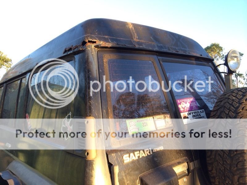

Could tell it was a massive yolo sort of car. Just from the first look I could see the rear brakes were clamped, rust all through the roof, side steps smashed into the sills, all the engine and gearbox mounts were snapped etc. From memory it had been sitting in the same spot for about a year with the rego up to date, due to insane death wobbles and a bunch of other problems. Carpets and seats were full of dust, paint was faded to sh*t. Pretty much a pig, but I could see it had a little bit of potential.

Classic rusty roof
Fixed it with some tape, almost good as new.

Decided to cut the roof off because it was rusty. Didn't really even have a plan as to what I was going to replace it with lol. Was thinking of a space cab chop, went through all the legal avenues to discover no one in my town can/could engineer a space cab conversion. Closest engineer would be Perth, and didn't really want to mess around driving there and back to get it approved..

Roof had a fair few rust holes haha. Unpicking spot welds would have to be my least favourite thing to do
Fixed up the holes

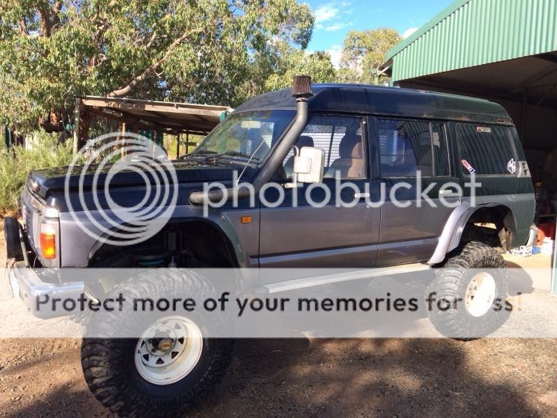

Couple more photos, this is about where I'm up to now
Made some sliders, 6mm mounts, gusseted with C brackets etc. Mounted with 1/2" High tensile bolts.
Knocked up a rear bar for it, 6mm mounts 48.3OD tube and 5mm fill plate. Painted it in 2k Polyurethane jet black
Flexez
Somewhere along the line I also replaced the control arm bushes and panhard bushes, chucked in the extended brake lines, front diff oil. Ripped the carpet out, was filthy as shiet, can see it has never been drowned and the carpet has never been taken out either. Zero rust in the floor which I was also cheering about, definitely the most mint GQ floor I've ever seen. Took the compressor out as it was all spastic and the solenoid for the front locker didn't work. Disconnected the power windows because they didn't work either, took the motors off and all that. High pressure cleaned the floor and wrecked the immobiliser in the process. Also sealed up all the holes with seam sealer so no water can get in the cab. Chucked in some floor mats for now
