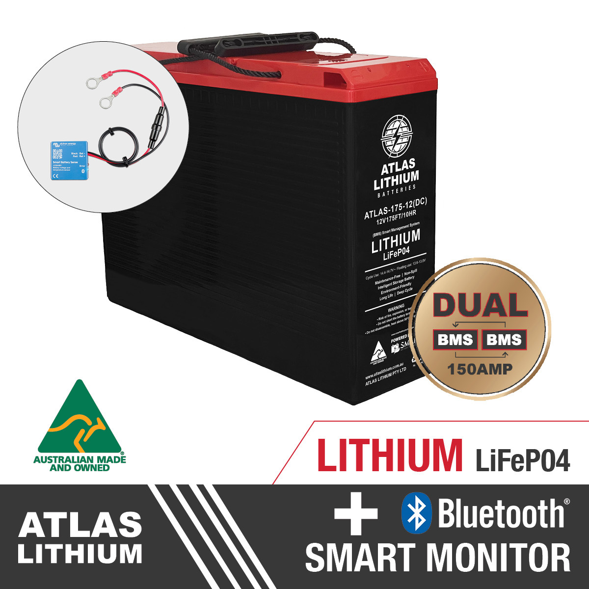

Slimline is cheaper
175Ah for $729 ($4.16/Ah)
Slimline is cheaper
Good value-for-money on specs. Nice to see an Aussie company producing an internal BMS that will perform as a drop-in replacement for AGMs (albeit non underbonnet), yet still clearly warns about maximium SOC of 97% for an AGM charging profile.

@heyhey and @Yeti's Beast do you fellas have an opinion on the batteries I listed above?
I have looked at the Atlas 75ah, but it listed only 1600 cycles which seemed very low. Is that right, or have I misread the spec? The Giant stuff has 5000 cycles form what I can see.
I have looked at the Atlas 75ah, but it listed only 1600 cycles which seemed very low. Is that right, or have I misread the spec? The Giant stuff has 5000 cycles from what I can see.
Firstly I take their specs with a grain of salt. "130% usable capacity" is not a thing haha. Otherwise, I've had good experiences with their AGM stuff over the years.
Yeah those Giant ones have much better specs even though listed capacity and continuous discharge are the same. The fact they list a Daly BMS is also a good thing for the Giant IMO. For the extra $30 I'd get the Giant over the Atlas. It's a pretty good offering if the specs hold up.
