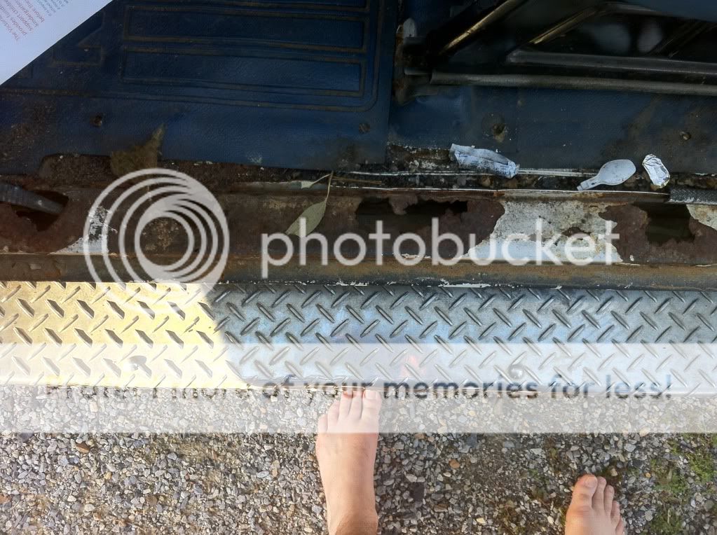

here are the first pics of my mk swb
it was an sd33t 5 speed
a few ppl have asked for pics so i will be doing a build up post
(mods if this isnt appropriate section pls change , would like it to stay here if possible)
front view half home made bullbar
lefthand side sill have new one made need to cut this out and weld new one in
rust on both sides this is the worst the brake fluid leaked there
more pics to come as i progress
will be a little slow at first because of the silly season
hope you guys will enjoy it

i hope you didnt pay much for that lol. my mate sold a rusty v8 one for $1200, but it didnt have holes like that!
nice bar too, look forward to seeing your progress :)

didnt pay a cent thats my shorty that my bro had then my dad now me
thats the only rust it has was complete car till i sold motor
i have complete sill made for it
surface rust on roof tho lol

Looks like you're going to be up for a bit of fun fixing that rust. Be good to see another MQ shorty on the road, mind you I've been seeing heaps of them lately :)

The rust looks bad but will be easy to fix as the whole sill is getting cut off
The inner sill is fine will be alot easier than if it was smaller bits
Surprisingly it looks worse in the pics than it is
