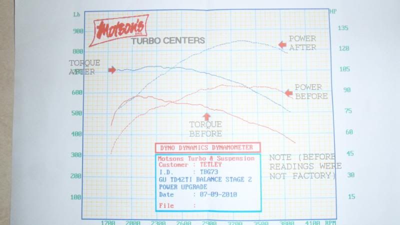

During my last trip away I came home via Brisvagas and had the Patrol booked in a Motsons for a stage 2 Turbo upgrade. Now to say I'm pleased with the results are an understatement. The truck now is far more friendly and easier to drive with heaps more torque and power down low where needed......Very happy to say the least, below are the Dyno results.....
The other bonus, she uses an average of 1ltr per 100km less fuel now, can't complain with that.....:D:D:D

well done teabag, what did the fellas over there do?

Hello Teabag,
I see on the graph a note that the "before readings are not factory".
What mods did you have before Motson's did their stuff?
Cheers,
Geoff

So what is it like under 1700RPM!!!!!

Hello Teabag,
Cheers,
Geoff
It had already had the Stage one which is 3in Exhaust and fuel pump set. This is the difference between stage one and stage 2......

It had already had the Stage one which is 3in Exhaust and fuel pump set......
That's where mine is at the moment (series 1, non I/C). I'd like more off the bottom, up to about 2500rpm for towing. I'm considering my next move. Can't decide between turbo upgrade or I/C. Did they do exhaust side only, or both exhaust and compressor sides?
Do you notice any negative changes to driveability? Turbo lag, etc?
Cheers,
Geoff
No, it is only 3in exhaust and dump. I honestly have not noticed any down side to the turbo mod. Motsons also do a couple of choices in IC that I am also considering. I think it was $1800 for a 180% better IC performance but you need to replace the bonnet scoop which isn't in the cost . They don't do that and have to take it to a Panel beater to do. I'm seriously considering it.....

Thanks Teabag,
No Motson's in Melbourne, but MTQ are not far from me. MTQ have a couple of upgrade options for the factory turbo. They can upgrade the turbo exhaust wheel only, or both the inlet and exhaust wheels. I'm told if both wheels are done it will make more power, but it can be a bit laggy and not as nice to drive. Did Motson's do both turbo wheels on yours, or just the exhaust side?

Thanks Teabag,
The Cross Country "Ultimate" intercooler looks very tasty.........
Cheers,
Geoff
Mate, To be honest, I'm not sure if they did both or just the one. It would be worth giving them a call to find out what they actually do and see if that is the same as MTQ....
