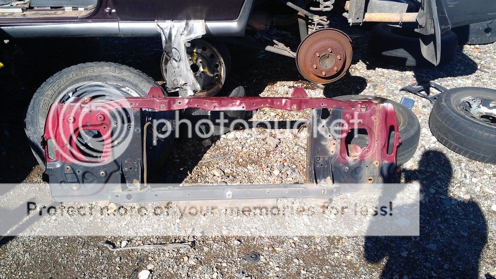

I've found a gq panel in great condition and if its doable, I'll do it. Where my radiator support meets the inner quarters there is more rust so im hoping this will just save time and stuffing round. Of course I lost the dimensions I'd written down of the gq panel. Thought?

Does the GQ rad support even go close to fitting?

It'll take a lot of cutting to get the GQ panel to fit, since the chassis' are different widths.
You'd probably be best off cutting replacement sections out of the GQ panel if they can be made to fit individually.

I reckon overall width was about 150mm more on the gq.. radiator hole has about an extra 100mm either side give or take.. and the body mounts are further apart. Thinking i could cut some out of the centre on a vertical axis and weld back together. In a thread about putting gq guards and gril on mq someone actually mentioned welding the gq rad support in but no more was said and that personseems inactive now.

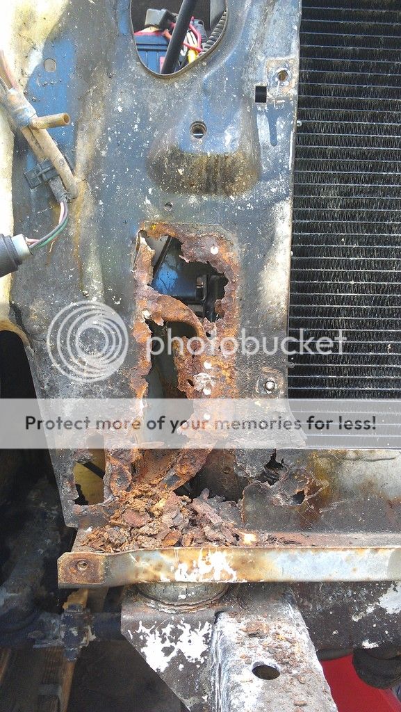

So behind the quarter panel isn't too bad surprisingly! Directly above the headlight on the top side of the radiator support is pretty rusty and has had a bad bog job done. Both sides are like this. But first things first, so yesterday i got stuck into some chassis rust near the bullbar mount.
I got this far before this happened
Hit the bone so off to get stitches. By the time i got home it was too dark to work and the missus wouldn't let me.

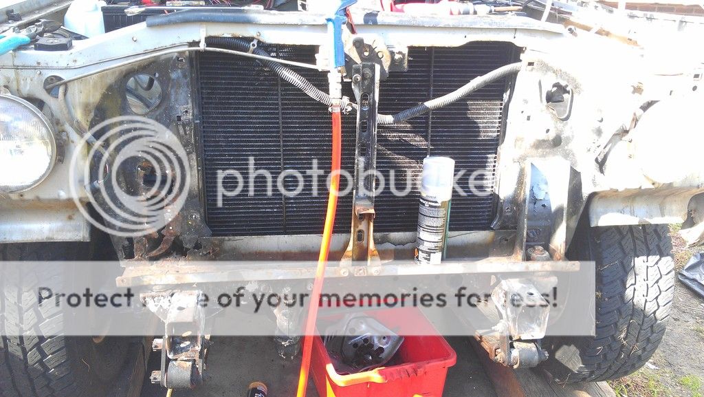

Got the plate welded in nicely, bit hard to clean the weld on the inside edge due to lack of space even with a die grinder. I was destroying a grinder bit in about a minute flat! It was rust treated then i used a weld through primer inside and out before welding. Pics to follow. Out of curiosity, how have you guys tackled the hollow spot behind the rad support on either side directly behind chassis mount points? It seem useless and an invitation to rust. Im considering soda blast then rust proof primer before i fill the whole hollow spot with expanding filler.
