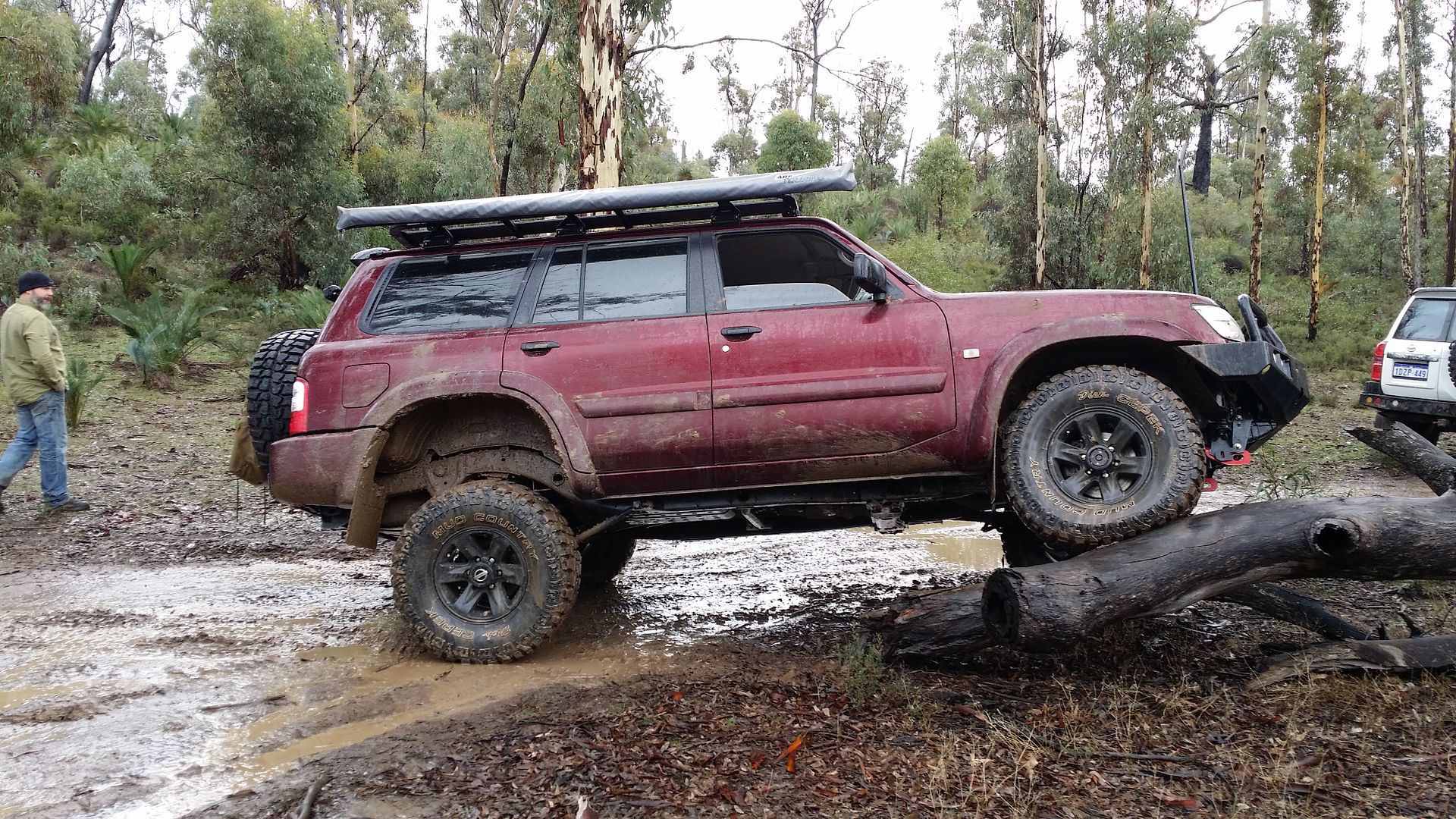

Yep, as Lee said, I've Plasti-dipped my factory alloys black. It's like $25 a can and I used three, so $75 all up. It's held up really well over the past year, through mud, sand, and even the Gerni can't budge it. Obviously it's not gonna last for ever, was just after the look until I get some new rims.
Like all painting jobs, it's all in the prep. I removed all four rims, cleaned them with the Gerni and soapy water, then wiped all rims down with wax and grease remover. First coat is just a dusting coating then I followed with three wet coats and let them dry for 24 hours before refitting them. Plasti-dip also do a glossifier if your wanting the gloss look.
Anyway, I'll throw some pics up for ya.
Also, how funny do patrols look with no tyres on them, haha.
This is the latest pic I have to see how they're wearing. This was taken a week ago.
