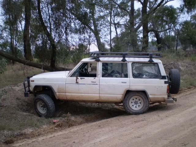

photo of my patrol before respray, should flex better now it has better front springs and longer shockies
I have another photo somewhere but can't find it, shows wicked flex in that pick.
The Prodigal Child Has Returned
7,305 Posts
standard front springs reset , 2" rear springs i think
falcon ute shockies and commodore wagon shockies as they are longer then standard patrol shockies.
Sway bar removed
and 2"body lift
mine should be better now but have not had it out yet have new front springs and shockies ready to go in. It rides heaps better now with new springs in front.
