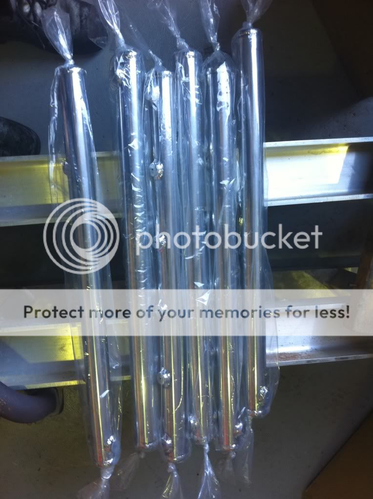

For people looking to do the Coolant Bypass mod on there TD42, ive just made up another batch.
PM me for details

This mod is to remove the micro boiling point in the top of the cylinder head, we use them a lot in combos running around the 600Nm mark. It is a simple but technical job to perform and yes you need to drill and tap a hole in the cylinder head in the correct place as outlined in the instructions that come with the rail once purchased.

yeah looks i guess simple enough. are the holes in a real pin point accuracy spot or you have a little bit of room to play with. and id assume the fitting instructions are pretty well detailed and easy to follow. just thinking if i get one its not going to be an impossible job costing me a head haha.
any chance of pm'ing me a cost of the setup and what id need to fit??? ie taps and the like.

I've done the mod.
If you know how to tap threads properly it's easier than you would think.
The hardest part is getting over being too chicken to drill holes in a good motor.
I must have fussed about for an hour at least before I got into it. And no, "fussed" isnt the first word I chose.
You can do it in an afternoon if you take your time.
If you don't follow the instructions then of course it could cost you a head.
Dont worry about swarf, most of it comes out the top of the hole, and you can flush the rest out the holes in the head with the garden hose if you want.
the tap is a fairly common size so you'll find use for it elsewhere.
It probably won't make your engine run cooler, if your car is getting hot thats a different issue and you should fix the cause. What it will do is stop the head cracking when it's being driven really hard.
