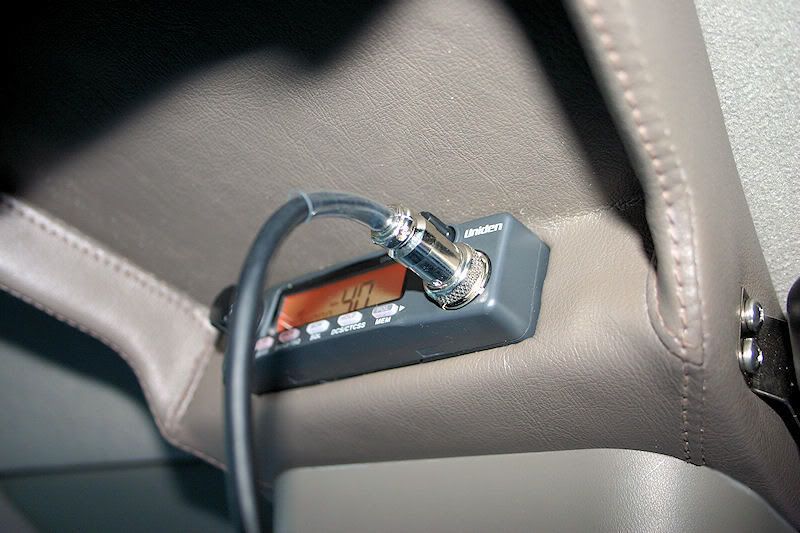

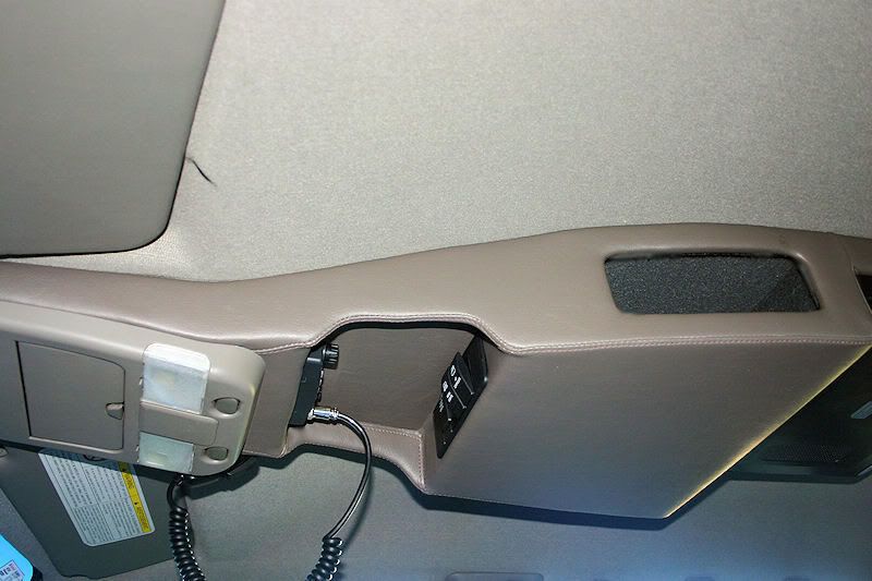

However anything I make myself Ill do a separate thread....so here is our roof console!
It is made out of 7mm ply. It uses the original front light. I holds the kids DVD screen, the Uniden, a 6 bank of switches and some storage space. I havent put any mesh over the storage holes yet because the floor is slightly recessed so I might not have to.
I had it professionally trimmed.
417 Posts
What'd it cost to get trimmed ? I've been half tempted to make a roof console, but wouldn't want some ugly POS that I made being so obvious, but yours look great after the trimming.
127 Posts
They all look like a POS when they are bare ply ;) It cost $200 to have it trimmed. It was a bit on the expensive side but mainly because I put the stepped up insert in where the UHF and switches go. All up the thing owes me less than $250. It looks professional (because of the trimmer), it fits perfect, it is custom made to suit our needs so for that price we are happy with it.
Thanks for the comments gents.

$200 is cheap mate, jop job, you try doing it with a bag needle yourself, you made a good choice, looks the goods.
· Currently in PAD rehab
18,443 Posts
looks awesome, great spot for the locker switches too, handy but not in the way to get played with by wandering hands (or the dog jumping in the front!)
Well done!
