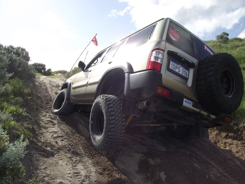

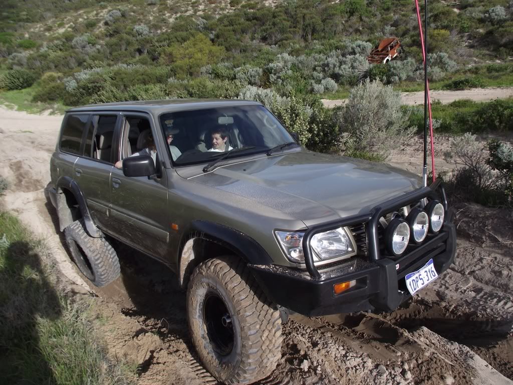

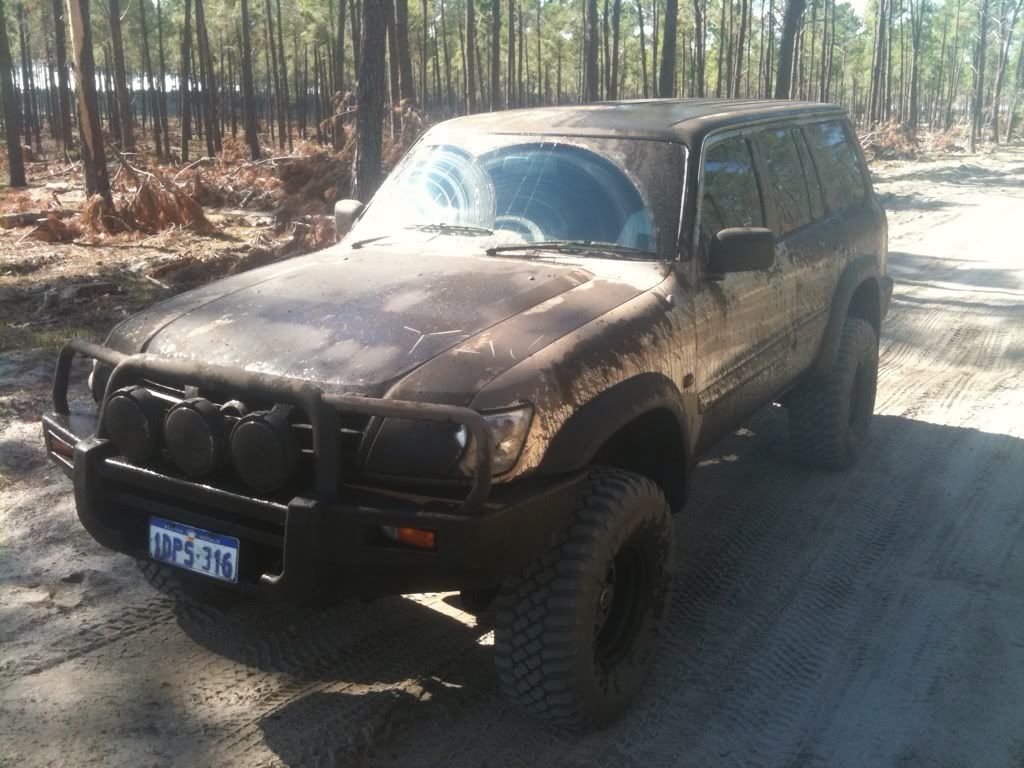

Been busy last few months, after a long sad break from the road lol
Wagon was getting a bit ugly lookin, bit of panel damage, put it on its side, bent some **** haha. So decided it was time for a birthday.
