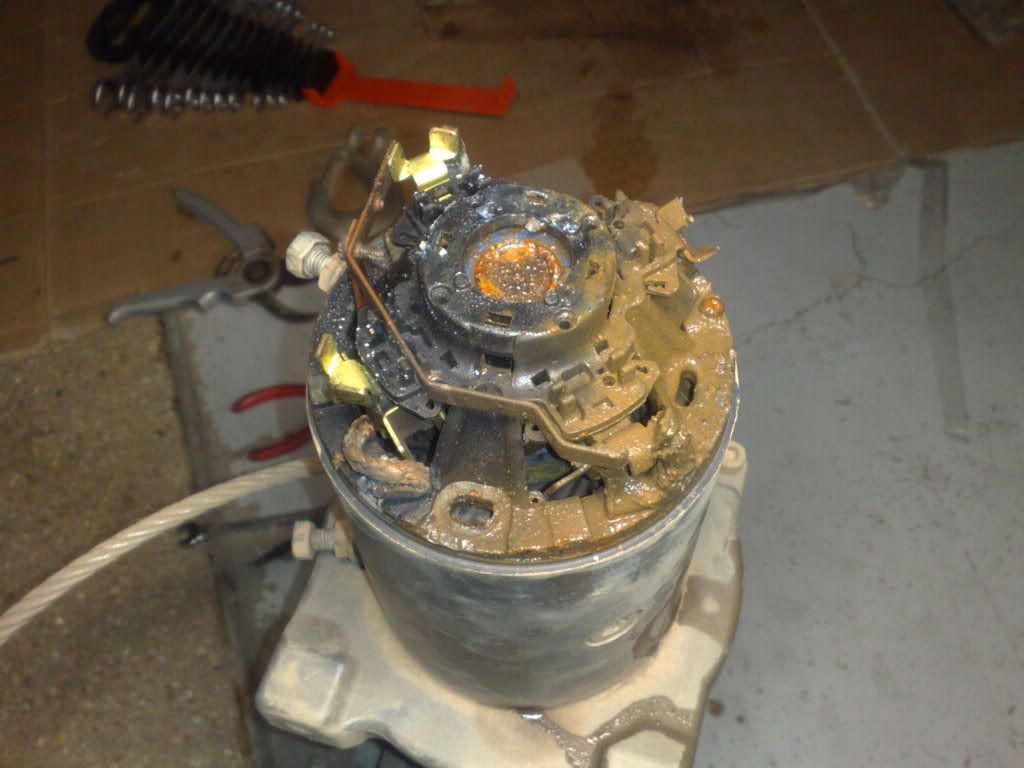

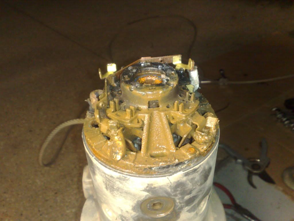

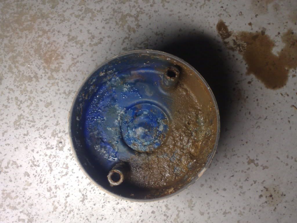

So anyway cos the winch is the sort of gear you need it to work, and it just cant fail, I decided to get the winch serviced. Heres what was found:
1. Winch still full of muddy water two weeks later
2. Mud and crud all through the planetary gearsets and so on
3. Two bearings holding the main shaft had seized
Basically it required a thorough rebuild and two new bearings
I'm dam glad I got it serviced now I never thought it would be that bad
Anyway its food for thought for me, just one incident and it did this.
