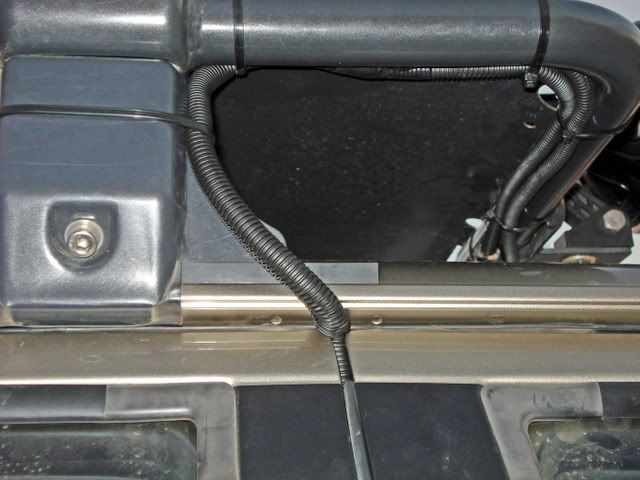

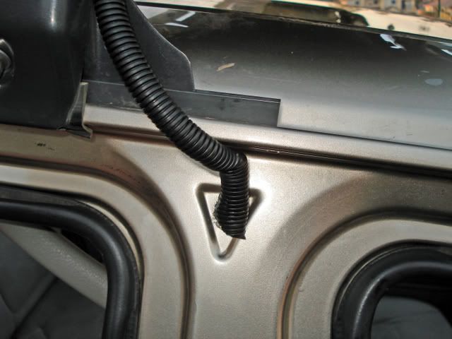

Hi lowy44,
did the same as above , but did not have to drill any holes. keep the wires running down further and use cable tie holders until you reach the rubber boot that the door wires go through. using anything sharp you have to pop a small hole in the top of the boot and feed your wires through. then you can simply run them along the inside skirt to were you want.
I will take a pic and post it for you
#13 ·
pic show how I did it, Hope this helps!
here are the pics has promised

#17 ·
GU Bundy and Damo GU I can hear the dogs barking.... Ruff Ruff ... you`re obviously not in any of the electrical trades .
Hole in the rubbr boot = water in car oh and those sticky backs will eventually fall off ... why don`t u use some super glue to stick them on next time ....ruff ruff ruff
Wires running past any rubber door seal = water in car
Tiny hole drilled in top of b-pillar with rust proofing and tight grommet for wires to pass through = professional [ and only way to do the ] job
Sorry boys couldn`t resist having a dig....
#20 ·
Diggings good-
Sorry boys couldn`t resist having a dig.... .
No... No...Diggings Good! Lmao:p
However, the rubber boot is still water tight
Silicone has been applied to reseal the boot (no water gets in). Also, where the cable runs it does not affect the front door seal (no wind noise) and if the sticky things come off.... for $2.50 I get more... DILIGAF..... I have used these sticky things for years on my other 4x4's and they haven't failed.... remiss of me, not to put it in my original post. Oversight on my behalf. :headwall:
And finally for my dig..:angel:. you are a genius Patrol King, I am defiantly not an Auto Elec, rocket scientist, mechanic, upholsterer, cabinet maker, welder or fabricator, tool maker ect... ect... ect... but guess what? I have a go...! and most of the time it works good for me with no regrets. Sometimes I F#$@*up too , but I blame murphy for that hahaha
Not fazed how anyone else does it. As long as forum members are informed of how other people approach different circumstance and can make their own minds up!
Just happy to share and also learn. This forum has been of great help to me.
