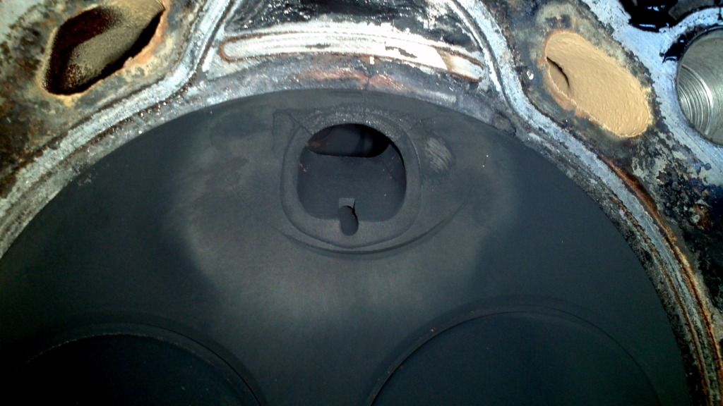

So off comes the head, few (6-8) hours later. Did a compression test first, 3&5 gave me 320 and 1,2, 5 gave me 400, and couldn't get to 6. Cold engine, no wetting of pistons with oil, figured what is the point, gonna take it apart anyway.
So some piston heads look ok, some look covered in carbon, and 6 has what looks like the corners chipped or bevelled off and the pattern on top not the same. Injector port 6 is pretty melted and exhaust (I think) valve with a nice crack going from outside edge to almost the middle of the valve. So I rekon this might be the problem. And also visible signs of leakage between 5 and 6. Looks like little score marks from something trying to breech the gasket.

The description of number six piston sounds like foreign body damage. Could you please put up a photo of the damage to the valve and piston?

Photos should be at the end of the original post. Can't get better one of the valve cos it's still in the head.. And the piston photo doesn't come out to well cos too much black for the detail to show up..

The valve looks something like that from the bank, but not as bad. Crack starts at outside edge about 4mm wide and ends halfway to centre of valve.
Other photos may be different angles etc. Can try N get more of anyone wants.

Hopefully some good angles. Looks like all pistons are ok except for 6. So I could get away with only one new piston and hone and rings... But can't hone the face without taking motor out.. :(
#8 ·
Number 6 looks like it's melted the piston by the look of the section where the precombustion chamber is

Haven't had the head cleaned and checked yet, didn't show a crack last time until we had it cleaned up, so may be the same... If that's the case I may go 4 new engine option...? More dollars though...

Did a search on head mod, didn't find anything. This isn't the factory head though. It overheated a few years back N we installed a head from Harris engines here in Perth. Was going fine until it ran away. As far as I remember the head had extra cooling channels that the stock didn't. Is this what you mean by mod? Or is there an external one I don't know about?
I don't know if the melted injector port is related to the damaged piston or the piston damage is a result of the runaway, and the injector is stuffed anyway...?

I agree with Inbits, the number six piston looks deformed from melting. The number six precombustion chamber too looks to be deformed. This photo is from a GQ head though the precombustion chamber shares the same part number.
Looking at your photos and the information about the catch can I would think that yes, you did pull aerated and frothy oil up from the turbocharger drain and into the intake tract causing your runaway. But I also think your number six injector jammed open and has damaged the precombustion chamber and piston as well as burning the number six exhaust valve. The white deposit on the valve is an indicator of very high combustion chamber temperature.
If the bore appears to be undamaged in number six you may be able to change the piston and have the head reconditioned. You may also be able to pull the number six connecting rod and piston from below with the sump off and if so you may be able to hone it. The RD28 is fairly easy to take out of the car though and I imagine it would be less effort than changing a piston in the car. I would think the valve seat for number six exhaust will be damaged as well. I payed $2090 for a full head recondition which included new precombustion chambers, valve seats 'n' stem seals, lifters and all machine work from Wearings Diesel in Townsville. It was done very well.
