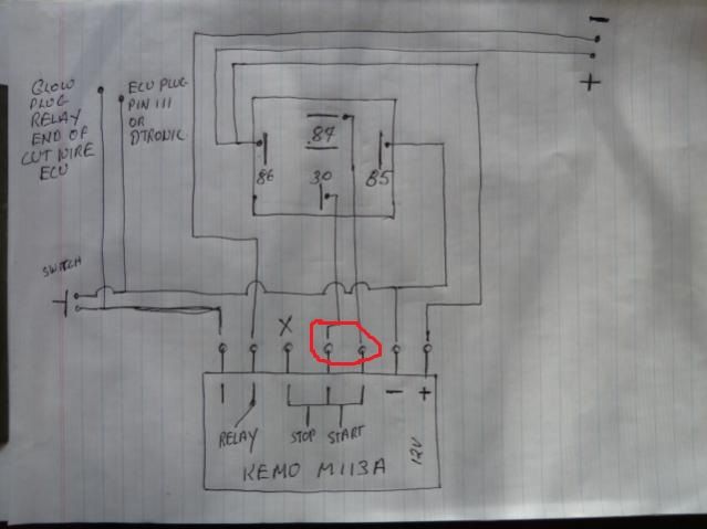

Ok guys so ive been trying to sus out the timer mod using the kemo timer an using this diagram as references... ive double checked all my wiring and relay and fuses
I just recived my metal tip bosch glow plugs, an decided it would be better to do the timer first before fitting the new plugs
So as soon as i start it up, the green light comes on, is the red light switch suppose to come on as well?
And how do i know if the timer is actually working? Its lighting up green which i assume means its on, but not sure were from here, how do u set the timing and know how long it sets it for?

Green light means the unit is powered up but timer is not active,
with red light on as well means timer is active.
There is small rotary switch/dial om its side which is used to adjust the timer period. To check the timer interval just use stop watch and observe how long the red LED stays on.
Try (instead of the relay)activating the timer manually by shorting the "start" terminal and common terminal. Check the instructions which come with Kemo unit.
I suspect that either you spliced in to incorrect terminal on ECU, you can check if the green LED is still ON after about 5 -10 mins after the engine is running, if it is you have.
If not than it appears that you are another case of timer not activating because the relay triggers quicker than Kemo powers up. See this thread -->
http://www.patrol4x4.com/forum/zd30-di-engine-3-litre-71/kemotimer-euro-au-differences-181586/
Kemo needs to power up first than the start terminals can be bridged/shorted which will activate timer. It is also possible that due to the product revision the latest version of Kemo are more sensitive to this than previous ones.

This is my wiring diagram and to date have had no problems.
I have noted that several members have indicated --- "It don't work".
The added relay I have been using is a Narva spotlight relay, 40 amp unit from, if I remember rightly, purchased from Jaycar. I don't think the brand of relay has any bearing on your problem.
When installing, I splice into the G/b wire at the glow plug relay. Not at the ECU. If you ask 'why?', only because I find it easier -- plus I pick up the required positive from the glow plug relay for the Kemo timer. (it's just a personal preference as I wished to use all the Nissan glow plug circuit protection -- fuses etc).
However the earthing for the Kemo timer and the start cycle is all thru the ECU supplied controlled earth......in other words the ECU controls the Kemo......not the ignition switch.
The only answer I have is -- check you have the required earths at the Kemo as per the diagram and the positive (12v +) is "hot wired" - meaning power is available to the Kemo at all times. Don't forget to add a protection fuse.
As a note...I have noticed the latest Kemo timers appear to be potted/moisture protected which means it could be mounted under the bonnet. Mine is under the bonnet, been there for maybe 4 years with no problems.
I have ran a new installation on the bench with no problems using the above diagram, using different relays, new and old no name units etc. No faults encountered.
My interpretation is that if it works on the bench.... then the way it is wired into the vehicle system will be the fault......like the + take off and the G/b wire install.
Question - is your Kemo positive switched ON via the ignition switch?
Lets know how you go -- I am interested.

Ok guys ive managed to get the thing to work, seems the relay was having issues, swapped it out with a 40 amp fog light relay, ANd now comes the next problem lol, i think ive got the newer version of the kemo, and with the added relay, its giving grief in some ways, im reading into the new thread about the different types of kemo
Once i put the ignition on, it lights up green, but no timer activated
Turn off
Put ignition back on, timer is active, SO, im assuming there is something else going on, as the timer should come on every time u put it into ignition before firing up
The kemo is wired straight onto the battery positive an negative, ive read so long as its a constant power supply, i should be fine

Hey guys i am Just a simple electrician but I have just connected 2 of these "mine and a mates" and I just made the control circuit up as I went and I didn't have any problems with the kemo unit that a lot of you seem to be having.
So I have put the changes that I made to the circuit into the original diagram so that you can see if it works for you.

OK guys HUGE UPDATE! With regards to this new diagram, it works! BUT in saying Soooo....
My power source is from the Wiper motors power, i spliced it in, an thus there is always power source even when cranking... Originally i did try the battery terminals, but this left the Kemo always on constantly even when the car is off.. not good
Having it powered from wiper power is better option as it only turns on/off when the car keys are in an out
In order to get to that power, u need to splice the wiper motor loom to expose the 4-5 wires...
similar to this:
It should be the only wire that has a red strip on it, indicating its positive feed wire!
but as it stands on, the only down side is the Kemo will only de-active once the keys are out and engine shut off... meaning the green light will turn off when the engine is turned off... It still gets the signal from the ecu to activate the timer
The timer runs as it should b minus the exception of it always being powered lol
hope this helps some one out!
